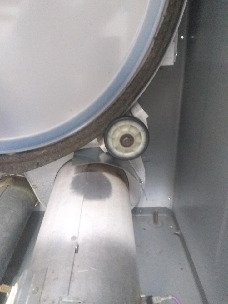

    Maytag dryer drum roller deformed
    Maytag dryer model LDE9804ACE. The lower right drum roller wheel which sits right above the heater element about every 18mo starts to get noisy due being deformed by the heat. I have just been replacing it but this time came up with the idea of making a second heat shield just below it. It will be a while before I know if this helps but what I am checking in on is this a good idea as in am I missing something and this will cause a problem? Below is a photo, I secured it into place with the screws already there for the blower. When running I do not hear any rattle or rubbing noise.

    Your idea of adding a second heat shield sounds practical, especially if it's securely mounted and not causing noise. As long as it doesn’t restrict airflow or contact moving parts, it shouldn’t cause issues. Keep an eye on performance over time to confirm it's helping with heat deflection.

      No idea how this will work out, but since it's not rattling or rubbing it seems okay for now. Just keep an eye on it, make sure airflow isn't blocked, and keep the venting clean so the heater area doesn't run hotter than normal.

        Will do, I clean the lint trap after each load and pull the machine apart to clean each qtr along with cleaning the very short (18") dryer exhaust outlet to outside.

          Sounds good. Just keep an eye on the shield over time.
