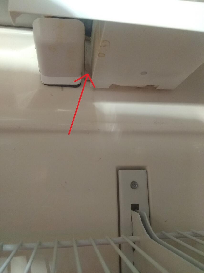

    Ok as my appliances continue the attack, my wife says that she every now and again is finding a small puddle of water on the lowest shelf. I looked and can see an small ice build up (see photo below with red arrow pointing at ice build up) in the fridge at the top where the cold air comes into the fridge with wetness down the inside back of the fridge from that point down. I checked the fridge (40degrees) and freezer (0 degrees) operating temps and they are correct. I removed the back panel inside panel of the freezer and I could find nothing there, was thinking maybe when the fridge does it auto defrost maybe there is a crack in the drain tray that is letting the water leak below? Did not see anything and pouring water into the tray did not result in any entering the fridge.
    We purchased the fridge new in 1986 and I have cleaned the coils and fridge every 3 months. Up till now its been trouble free although some of the plastics as you can see in the photo are turning a bit yellow.

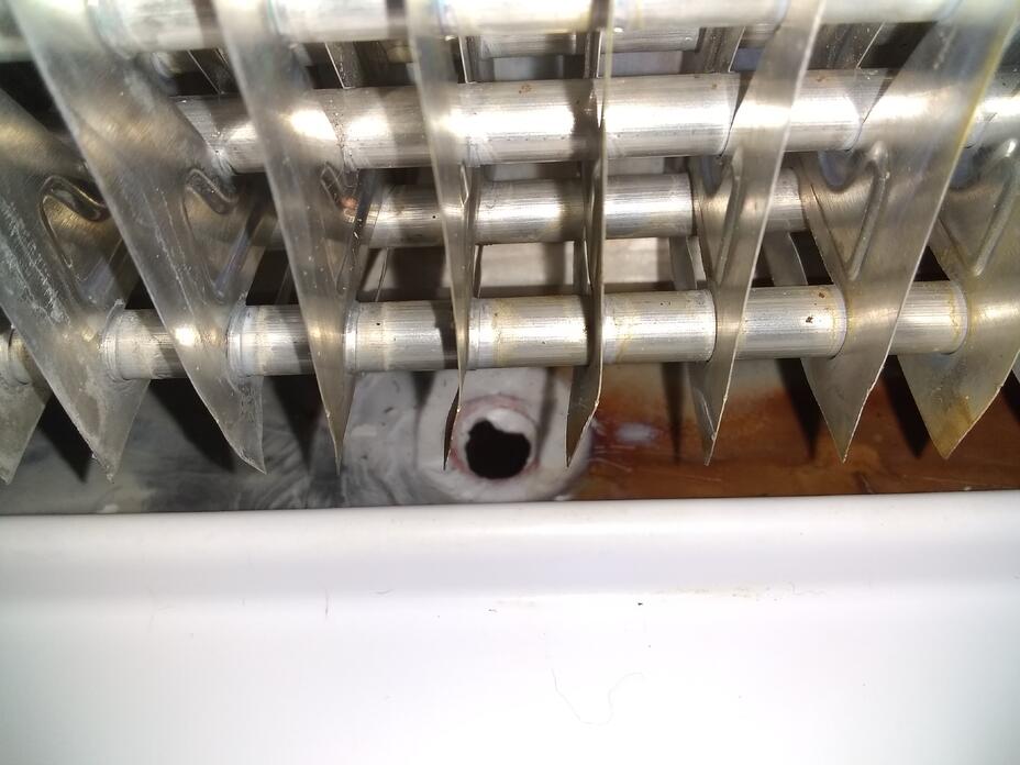

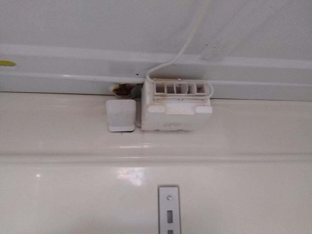

      Ok finally got back to this, life got busy for a while. I was able to remove the back panel and lower panel in the freezer. With the better view above and below I could see that the freezer drain has a hole that allows the water to drain down into the lower area but has no tube to direct it through both layers into the open catch piece. so its gets between the two layers and had caused a small rust hole in the fridge box.

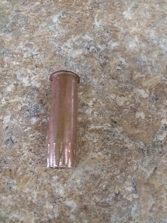

      I was unable to remove the insulation without damaging as my first idea was to clean and repair the damage with some epoxy so my next plan was to make a drain tube out of a piece of 3/4" copper pipe to direct the water from the freezer to the catch area in the fridge.

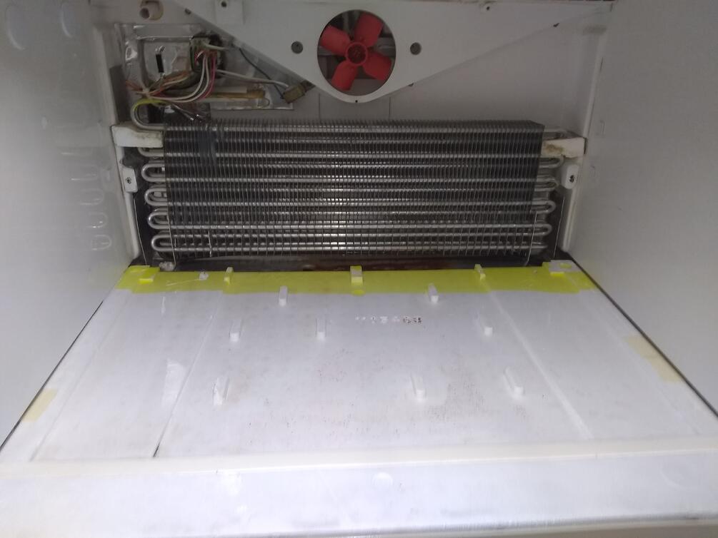

      I added some sealer to the top and installed in down through the drain hole into the cup.
