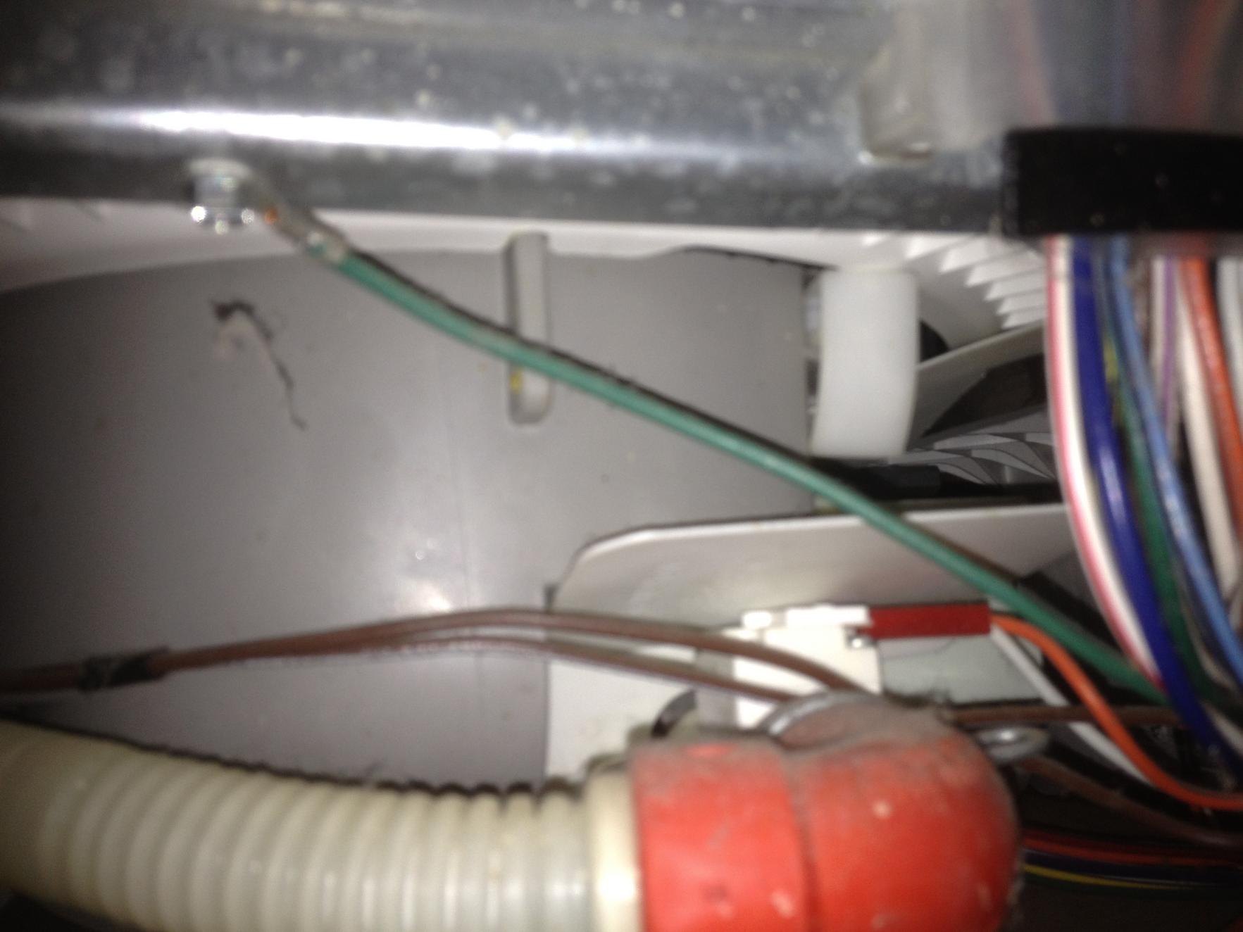

    First picture is from the inside and where I should have been able to get to the impeller (know its small, but I can't post links because I don't have enough posts)

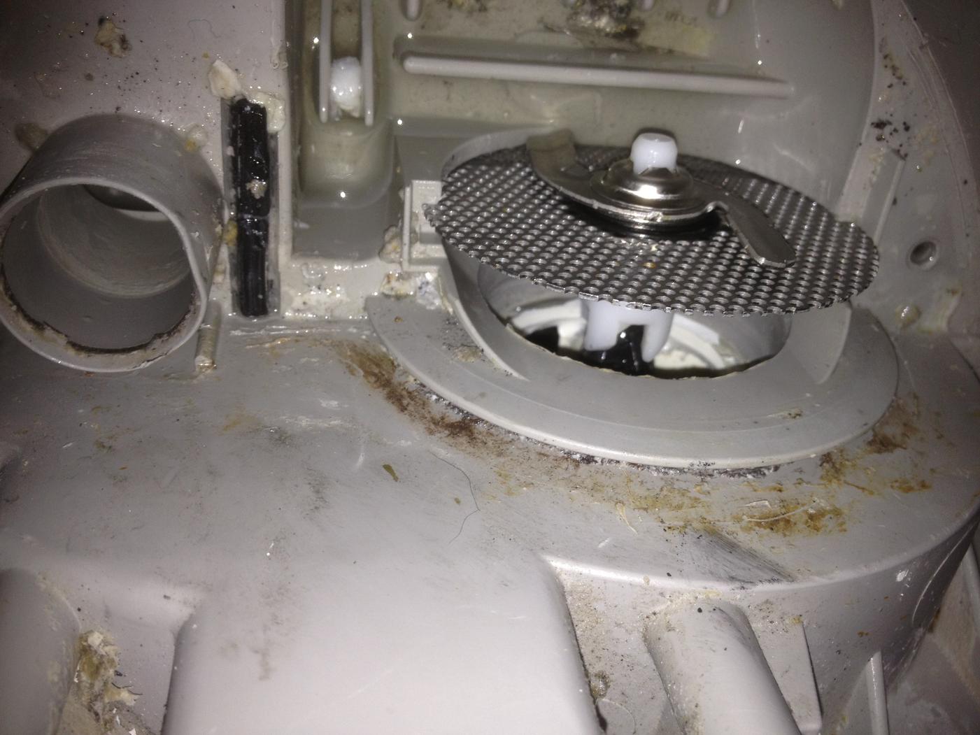

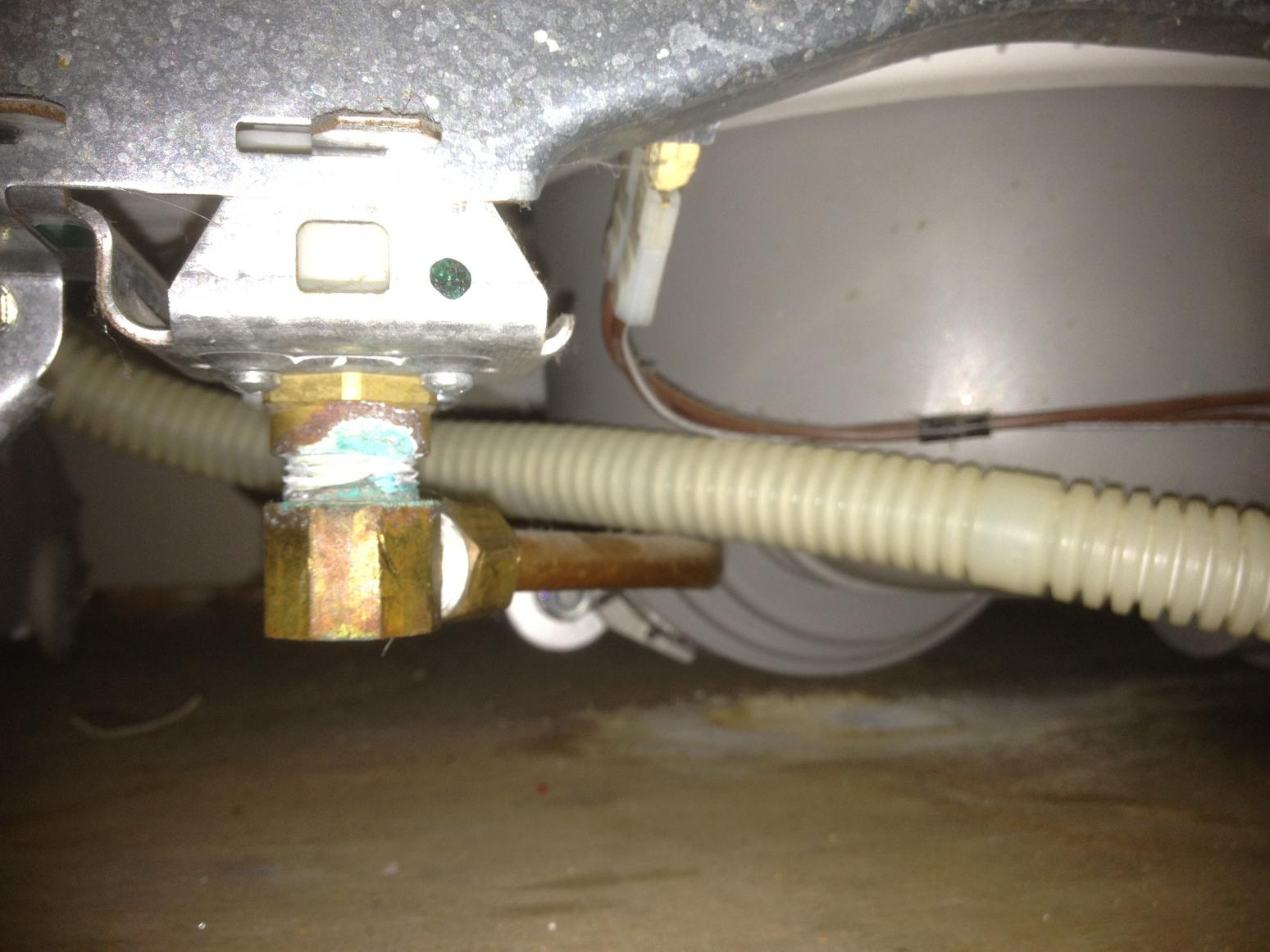

    Second picture is the water line, if I remove the whole unit and disconnect the water line is that white stuff some sort of sealant I would need to reapply or is that nothing important?

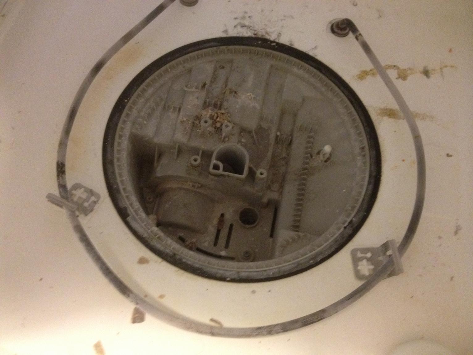

    Last picture you can see a plastic clip in the top right, there are a couple under there from what I can tell, will those help me get access from the top side?

    my dishwasher hums during the wash cycle, looked it up, sounds like it is an issue with the motor impeller
    It could be something jammed in, or a problem with the pump's chopper blade (see the following link). It is a fairly common problem area.
    LINK > GU1200XTLQ1 Food Chopper Assembly
    Not yet, there's more disassembly still needed to access the impeller. The page at the following link (and the video at the link above) shows a step you are likely missing.
    LINK > Whirlpool built Dishwasher Chopper Repair/Replacement

      Thanks! I feel like an idiot! I missed the screw in the bottom because of how dirty it is

            Im having trouble getting the pump inlet protector off. I can't get the thing to budge, I've removed the screws, ive tried wiggling it, pulling up with force, using a flat head screwdriver to get separation, and no luck so far. Any tips? It is not coming off no where as easily as the video showed
            • ACardAttack
              • Jul 2012
              • 8
              Finally got the thing off, on the chopper, there are no blades what so ever, looks like the broke off, but I can't find anything that looks like blade parts, so I have no clue what happened to...gonna go up and get another chopper from the local appliance part store
              I cant get the new chopper installed!!! I get it in there, BUT it doesnt lock into the impeller, even with maneuvering. Also when I rotate it, I can tell one blade is scraping against plastic on the bottom. Probably hard to see, but I cannot for the life of me get that white part to engage with the impeller. I have the screen in the right slot, perhaps did the place give me the wrong chopper?

                Finally got the thing off. on the chopper, there are no blades what so ever. looks like the broke off, but I can't find anything that looks like blade parts, so I have no clue what happened to [it]
                Hopefully it didn't get sucked into the pump. If it did, the motor might have to be dismantled from the pump to access the internal parts. See if the motor can be turned by hard before installing the chopper.
