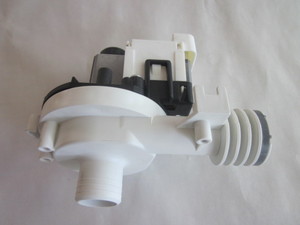

    I inspected the drain pump (WD26X10039) when I had it out. I noticed that the impeller has four flat paddles rather than curved vanes (think "turbine"). Seems to me, an impeller built with curved vanes would draw waste-water efficiently and thus propell the gunky stuff out of the dishwasher like it's supposed to. I have a theory that this specific drain pump mostly just churns the waste-water which renders food scraps into sand-like particulate, the heaviest of which never get pumped out of the machine do to the inefficient design of the pump. Indeed, the OEM replacement pump shares the same impeller design. Not surprisingly, replacing the pump did not resolve the problem.
    That wouldn't explain how it got back into the machine.
