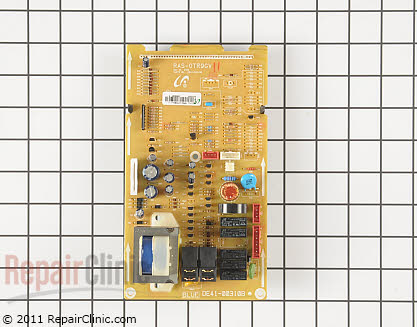

    This behavior suggest to me that there is a mechanical switch or relay or solenoid in the unit that is gummed up in some way. Sometimes it sticks in the off position; sometimes in the on position. The thumping seems to jar it loose.
    Any relays in the unit would be part of the electronic control board (see the following link).
    Your symptom might be due to just a loose wire connection or possibly a problem in one of the door switches (there are at least 3). Unfortunately it might be more likely to be a problem with one of the electronic control's relays in which case the electronic control would usually need to be replaced to correct the condition.
    GE JVM1850SM3SS Electronic Control
    (The two black rectangles in the center, at the bottom of the board in the pic are the relays)
    Unfortunately the control board for your model (part # WB27X11070) may not be available any longer and the original might need to be sent away to be remanufactured if defective.
