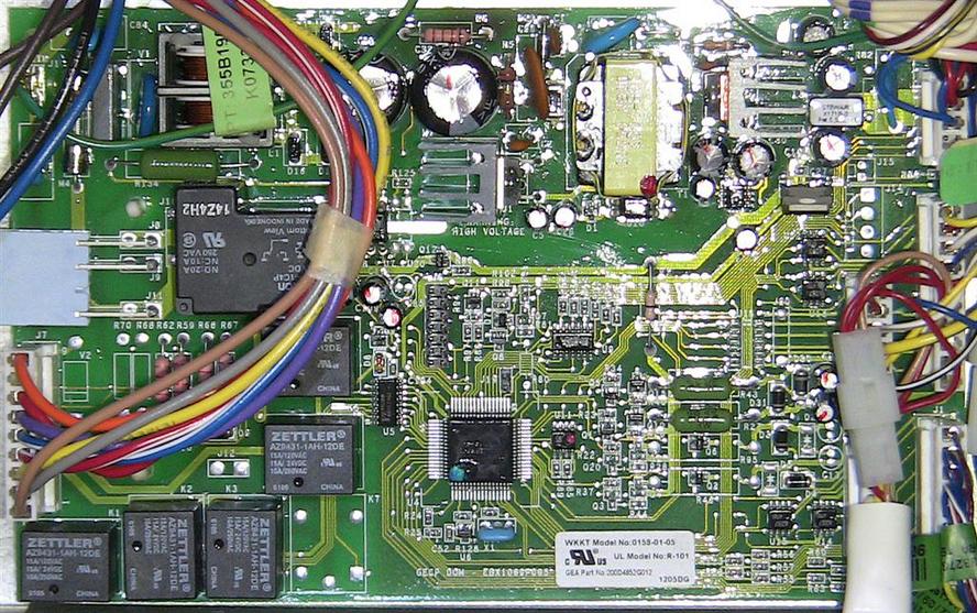

                            Success at Getting a Complementary Replacement Main Board from GE!
                            The Problem
                            The "intermittent howling freezer" issue affects a variety of refrigerator models that use the same model mainboard (MB), which is the source of the problem. Add'l symptoms of a faulty MB include issues at the ice/water dispenser when dispenser paddle is depressed:
                            - dispenser LEDs dim and no ice is dispensed;
                            - dispenser LEDs dim and no water is dispensed;
                            - damper solenoid clicks and evaporator fan shuts off.
                            Our model, PSS26SGRE (circa 2005), suffers from the howling and the dispenser problems, clearly indicating a faulty MB.
                            During online research, I happened upon this conversation thread--specifically, the post I include below. I studied the text of it carefully then contacted 'GE Appliances Consumer Relations' (800-386-1215) and choose option #5 ("Speak with a consumer relations advocate"). The result of my call today, 08/31/2011... GE is sending me a replacement MB (p/n WR55X10942) via FedEx at absolutely no charge.
                            The bottom line:
                            GE is aware of consistent and pervasive problems caused by a specific and faulty MB installed into various models of refrigerators built ~2003 thru 2006. GE issued an internal recall under the moniker "Main Board Program". If your refrigerator has any or all of the issues described here and elsewhere, as a registered owner of the affected appliance you are entitled to a free replacement of the defective MB.
                            Study the post below before you call. When you do call, be respectful, patient and firm with the consumer relations advocate who speaks with you. It is evident from the many accounts posted in this thread that different representatives interpret the GE's policy... well... differently. If you are connected with a nudgy rep, simply keep in mind that you are entitled to a replacement part at no cost and press the matter with a firm tone using the information here. If it becomes obvious the rep is not working in your favor, simply end the call, then begin the process with another Consumer Relations Advocate.
                            My call to GE
                            With my appliance model & serial numbers in hand, my call to the GE Appliance Consumer Relations line proceeded as follows...
                            - After jotting down the rep's name and extension number, I provided my name and phone number. I then calmly read the following succinct, prepared statement: "My refrigerator, model PSS26SGRE, makes an intermittent loud howling fan noise from the freezer. I understand this is a known problem to GE, and that an internal recall program exists for the faulty part that causes it. I would like that replacement part sent to me."
                            - I provided my serial number upon request. The rep explained that my model was no longer under warranty; she then offered to schedule a service technician to visit my home. I countered with: "I would like the replacement part sent to me under the 'Main Board Program'. May I have a case number for this call, please."
                            - The rep was very polite, and seemed to shift to a different mode immediately. She reiterated my request, provided me a case number, and turned to the business of gathering requisite shipping information. She then summarized that the replacement part would be sent to me at no cost--and sans warranty--via FedEx 5-day. I confirmed the part number (WR55X10942), and requested the part be sent overnight. She agreed to send it FedEx 2-day. I do not need to return the defective part.
                            Thank you to all who experienced and endured the resolution of this problem before me, and posted your account. It helped me.
                            Do NOT pay to replace this defective​ part! Make the call and make your case.
                            the infamous "main board" Click image for larger version
Name:	GE Profile Main Board.jpg

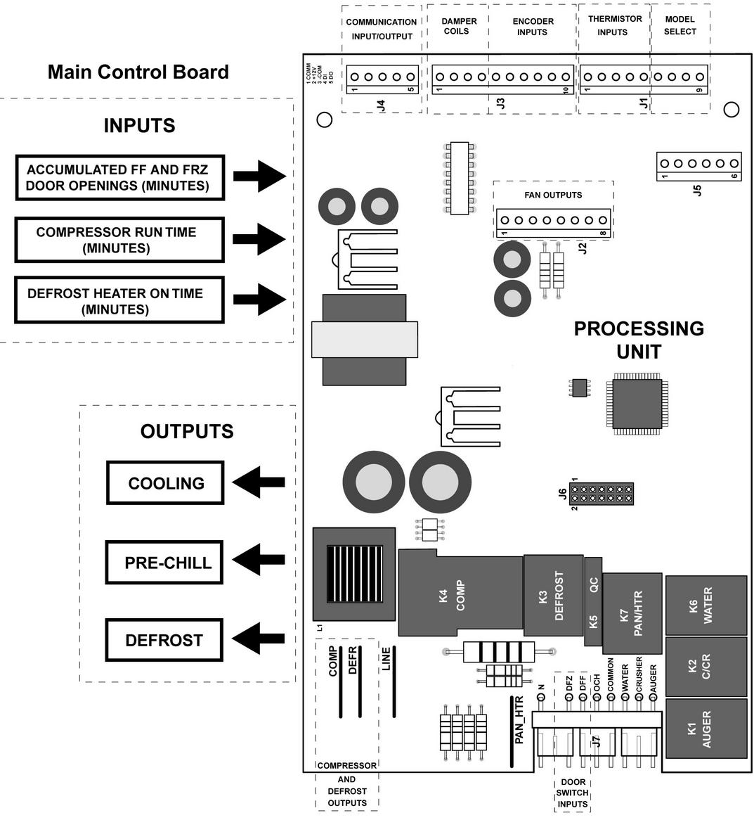

                            a service manual illustration of the same: Click image for larger version
Name:	GE Profile Refrigerator PROFILE ARTICA SERVICE MANUAL-Main Control Panel.jpg
