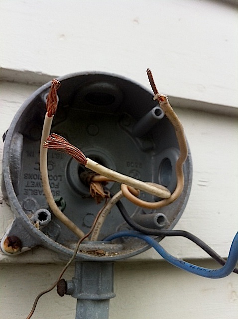

    Too many wires in box for exterior floodlight
    I'm hoping to replace an older exterior floodlight. I took the old fixture off, and found a tangle of wires in the box which puzzles me.The overall situation of the box is this: There is a light switch inside the house just behind the box. Outside the house there is a GFI outlet and a conduit going from it up to the box. The switch controls both the GFI outlet and the floodlight. Coming out of the conduit I have two white wires and a blue; coming out from the house wall I have a white, black, and bare (grounding) wire. The white from inside the house seems to have been coupled with one of the whites from the conduit. (see attached photo). The black wire is the only hot wire.I have a new floodlight socket ready to go -- but of course it has just one black, one white, and one grounding wire. How the heck to I connect it?

    box
