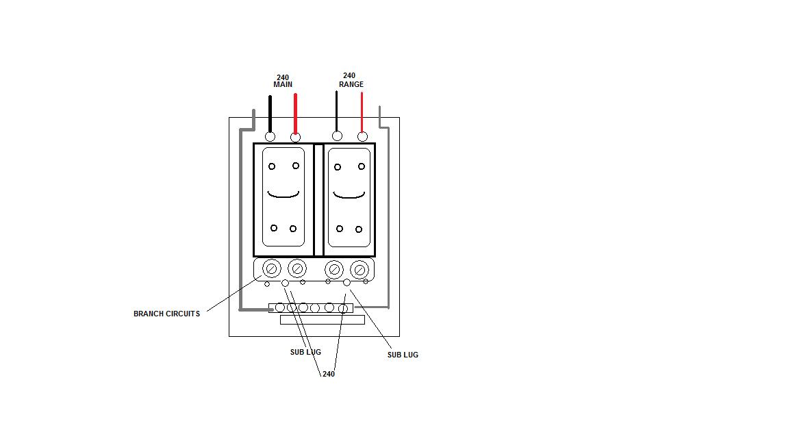

        between these two pullouts is another "sub-lug" screw, one in each center configuration. I'll draw a pix of it.

          here's a diagram of a typical old entrance. upon reading your posting, I saw you have six branch circuits. my drawing only shows four branch circuits. go it accordingly. Click image for larger version

            Yes, Hayzee, except for the smiley faces in the center and that there are eight plug spaces, it is the same!
            And as for sounding like an idiot....not by a long shot. You share too much to ever be thought of that way.
            Of the eight positions in this panel only the lower center two are empty. I will follow your suggestion and snug all I see in there after I get that panel lid off. I did not notice if the center lug of the plug socket had screwdriver slots. But I did see the questionable socket did have what appeared to be evidence of arc. I'll be checking it out in about two weeks when I'm back out there.

              all well and good Bob, but those "smiley faces" are not smileys. They are the bail handle you use to pull out the "pullouts!"
                Ahhh...my humor got lost in the typing......
