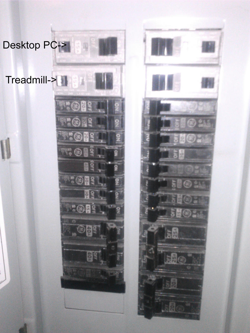

          Thanks for the direction on this issue. I suspect the AFCI (breaker) as you mentioned. I have also had problems with these breakers this summer when I was charging a car battery, but I don't rememeber which breaker it was. Here is a photo of what I am working with, again thanks for the information I will post back after I try a few things:

            the first four are the arc fault type, the remainder are regular half sized breakers. a standard breaker fits a one inch space, a two pole would occupy two one inch spaces.

                  if you have enough spare wire in the panelbox, try moving the load wire to another afci breaker and see what happens.
                  breakers that are inter changeable within a GE panel are made by Crouse-Hinds, Challenger and Westinghouse. Arrow-Hart may also be changeable but I don't remember.
