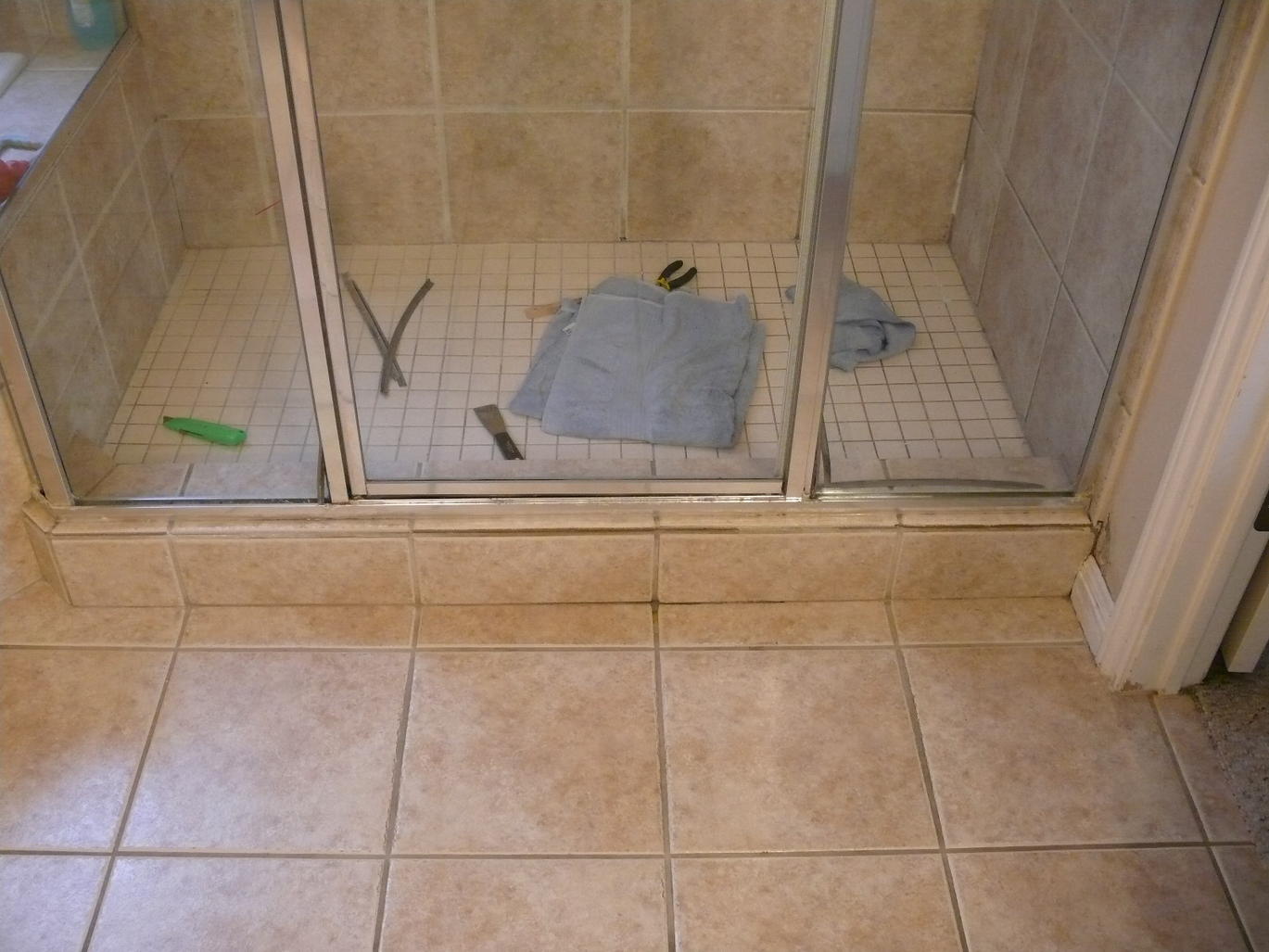

    Overall shot:

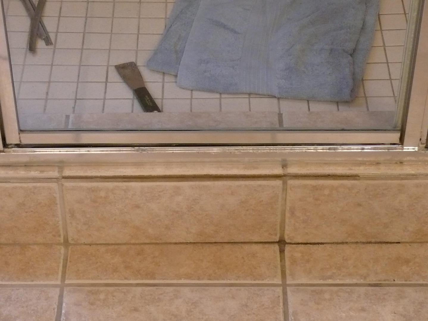

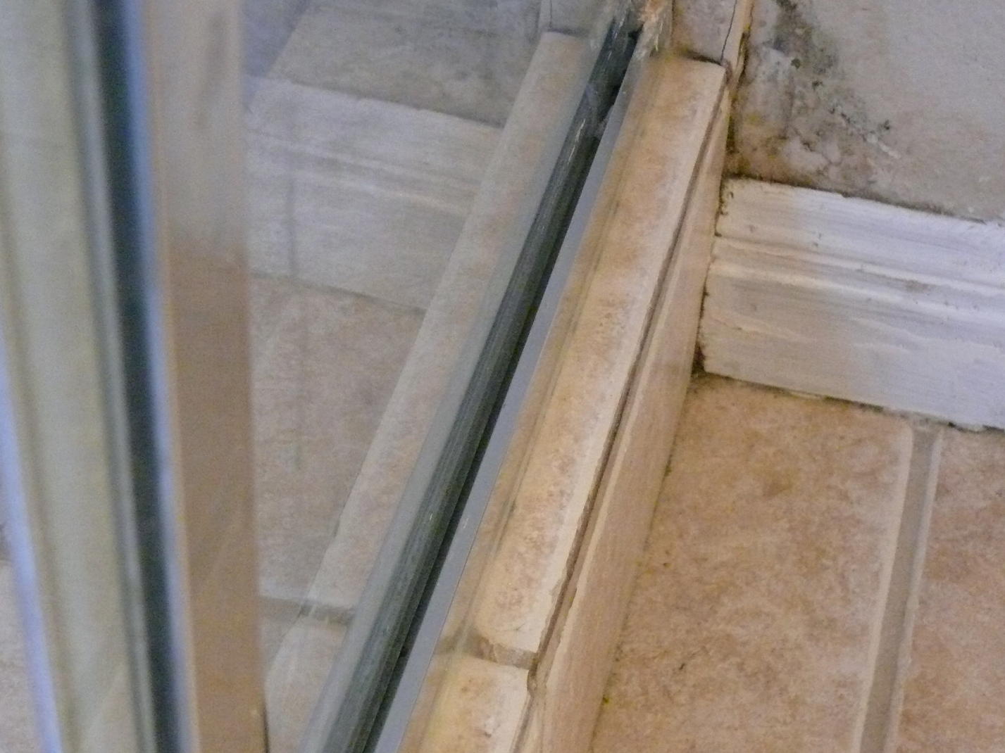

    Close up of outside channel with rubber strip removed, see small patch of mold on wall:

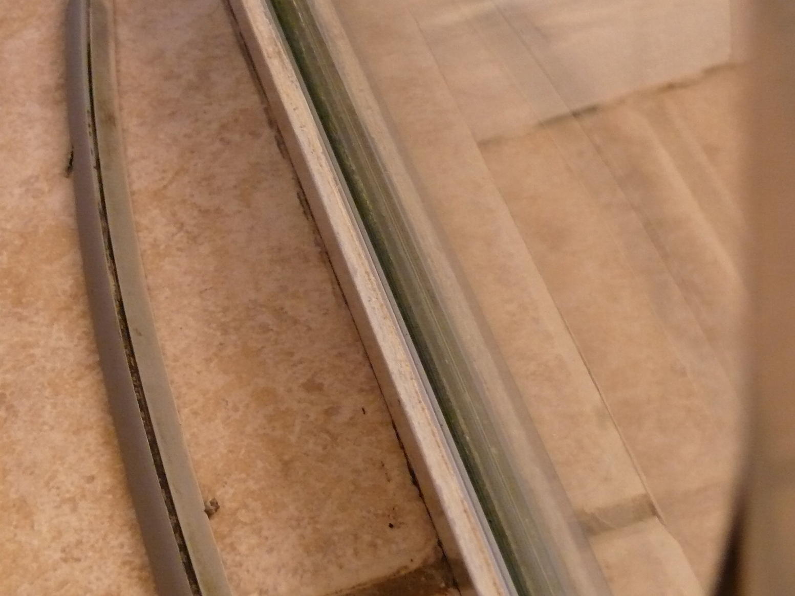

    Close up of other side of shower wall, rubber strip removed.

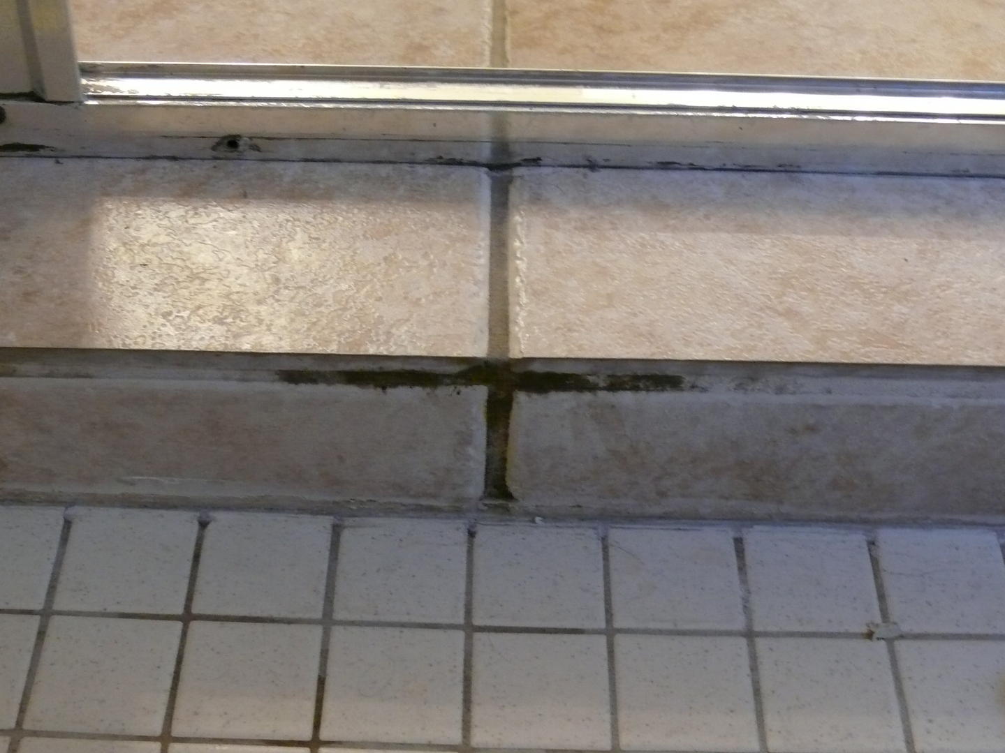

    Suspicious grout discoloration inside shower door:

    Most often with shower doors like your it's the rubber glass strips that deteriorate allowing water to drop down the glass into the aluminum frame, this frame is not water proof and will allow water to leak out, so the rubber gaskets should be replaced if you see any deterioration they are available at most glass supply businesses. You will need to either take your existing gasket or glass and frame measurements to make sure you get the right size gasket. The bottom gasket is the most important as water falls down the glass but the sides are important to keep an eye on as well.
    There should be a continuous bead of caulk all the way around the INSIDE of the frame wall channels and floor channels, any break in this caulk will cause leaks and is especially common in corners.
    The bottom channel should never be screwed into the curb (raised section).
    Also check the curb for cracked grout, this will allow moisture to wick through under the frame.

      Thanks much, exactly what I was looking for. The sides APPEAR to be intact, though I did peel them back a few inches from the bottom to get a better look at things, and there is a bit of gunk under them. Would you advise replacing ALL the gaskets just to be sure ?
      Would Home Depot or Lowes have this ?
      Are you saying that normally those rubber gaskets should be creating a water tight seal by themselves ? Or in conjunction with a bead of caulk down inside the channel ?
      I do see possible hairline cracks in the grout where it meets the tile, I guess that's from shrinkage (?) That would certainly explain the stained grout I show in the pics.
      Also, how long should a caulk job last ? It seems I only get about 6 - 8 months out of it and it starts shrinking and losing its grip on the tile and gotta do it all over. I am using silicone caulk and do clean the devil out of the surfaces first.
