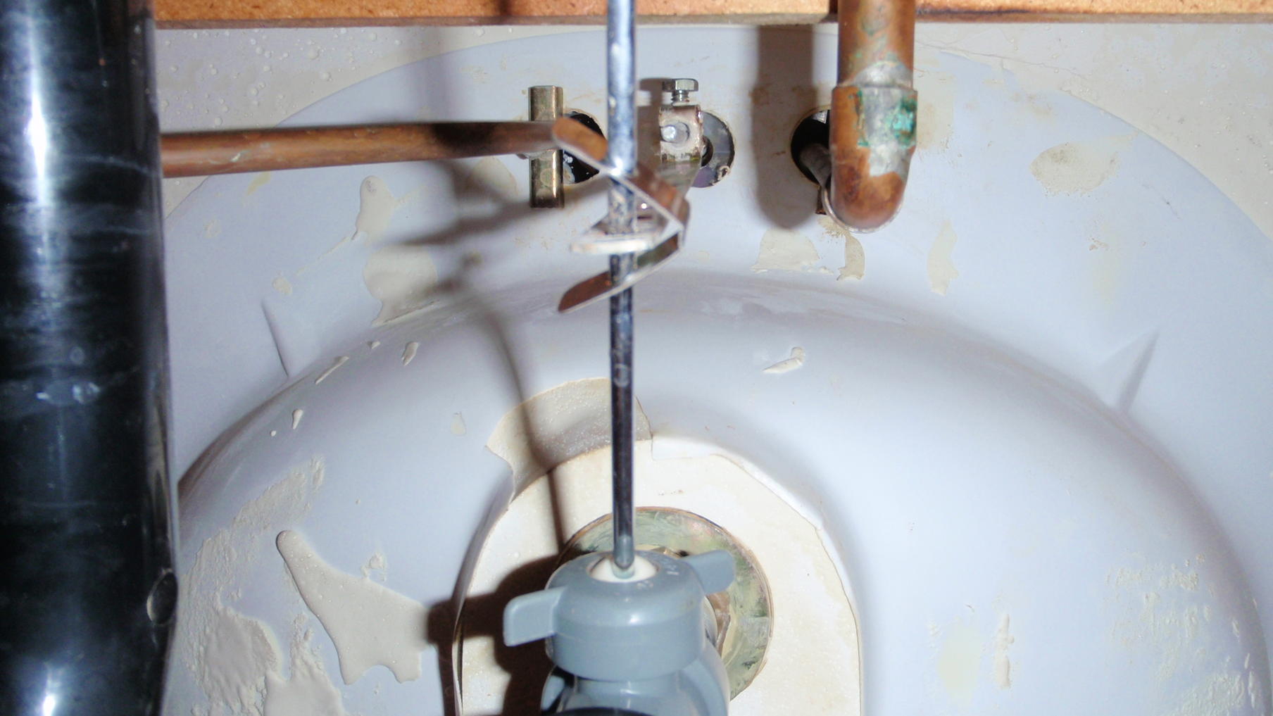

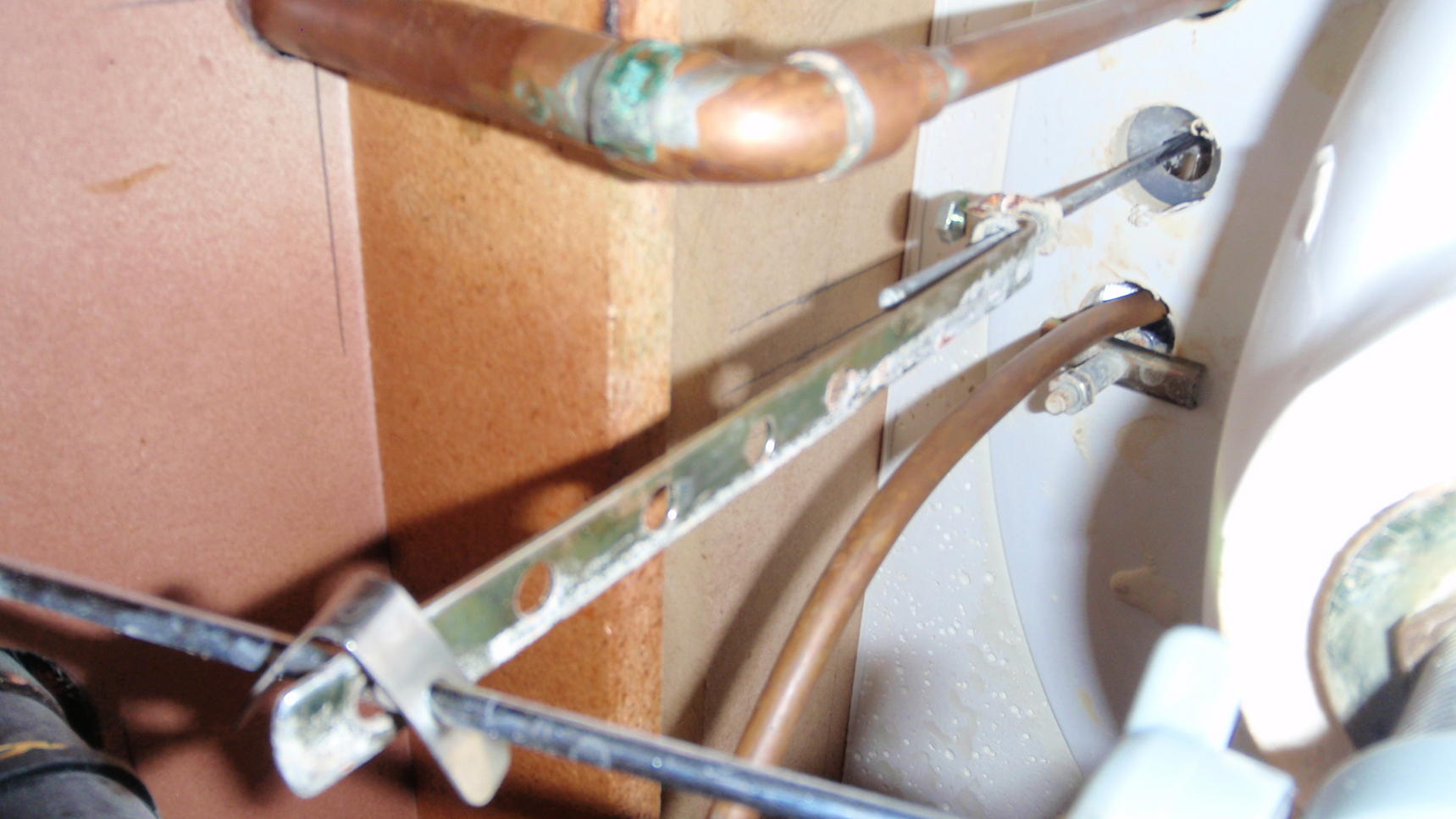

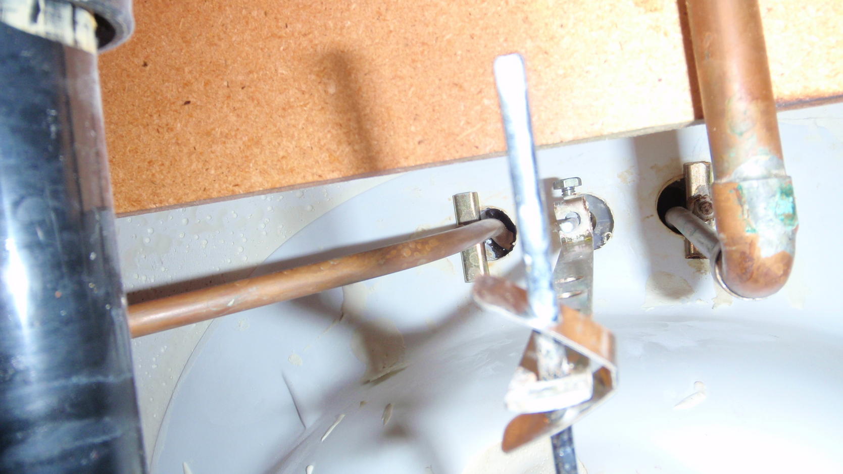

          This is a view from under the sink. You may also notice that there are no stopsClick image for larger version
ID:	87068Click image for larger version
ID:	87070,the faucet is soldered all the way to the faucet. I was told when the house was built (1995) the code allowed that. Now I am rethinking tackling this job...

            since you show copper coming out of the wall, I would suggest you install angle stops under the sink and the flex lines to feed the new faucet. just because they said that stops weren't necessary way back when, does it make sense to install them now? I mean you don't have to shut off water to the whole house just to service a bathroom sink faucet. use the angle stop. if soldering isn't your forte then use "shark-bite" connectors for copper pipe.

              Yes, the problem here is that those narrow copper tubes are what supply water to the faucet, and they are soldered directly into your house's copper supply piping. So, you need to shut the water off to your house WHILE you do this job. This is a good example of why you can never have too many water shut off valves.
