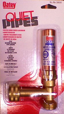

    Hi All,
    I have two of the small Oatey water hammer devices - one at the supply pipe after the whole house filter then another right at the washing machine.
    They have been installed for 2 years now the and the cold water hammer is back. I understand there are o-rings and cushion of air inside of these devices.
    So the question is can they be repaired? I beleive they are waterlogged now. These devices have a copper tube soldered into a brass base.

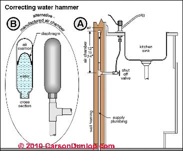

    Its unusual to have a water hammer device for the whole house. Usually they are installed at the device that has an ubrupt shut off potential, i.e. a washing machine valve. If yours is soldered in then you need to shut off the main, unsolder the shock absorber, drain it and re-solder it into the pipe. If it is one that uses hose fittings then shut off the water flow to Click image for larger version
ID:	87128Click image for larger version
ID:	87129it, unscrew the bib fittings drain it and re-install it.
