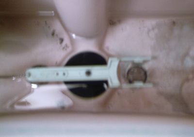

      I finally figured out how to take a picture of it. I got a lamp from another room, hooked up an extension cord, and put it right above the tank to make the lighting right. Here is a picture of the setup:

      I also did more research on this topic and found out that my toliet is produced by Eljer. Apparently this is a common flapper for their toliets and universal flappers aren't compatible. I found a few potential Eljer replacements on amazon and ebay. I guess I should order some and see if one of them works.

        ok, that pix explains a lot. I did find out that a push button flush operates off a cam that moves a lever upward, which in turn is connected to a chain on the flush flapper.
