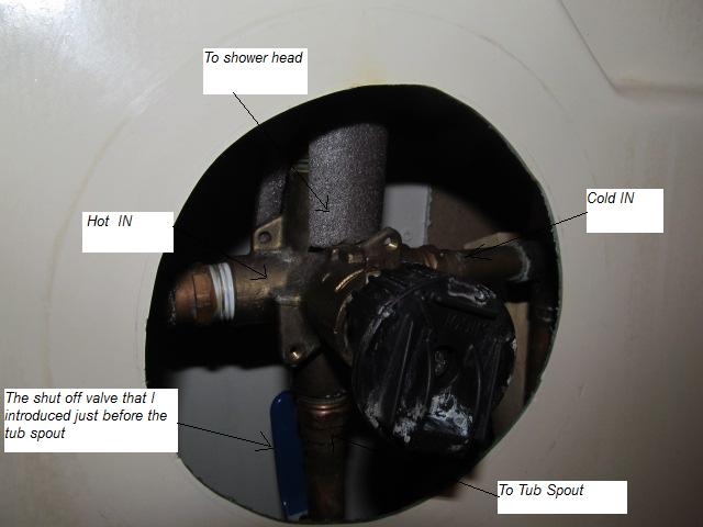

Name:	Main mixing valve.JPG
ID:	87254 There is almost nothing to this valve and my guess is it has just one ball type flow-true thingie. I don't see anything like a cartridge on neither cold or hot side. Please see the picture.

                  Conclusion:
                  My conclusion of this issue is that two things went wrong at the same moment. When I put the valve in the soldering must have caused the faucet the fail.
                  Taking apart the faucet was a challenge but together with this forum, Youtube video's I got it out. I did not see any issues with it.
                  I put the faucet back together (after greasing it up) and all works fine now.
                  I learned a lot THANK YOU ALL.
