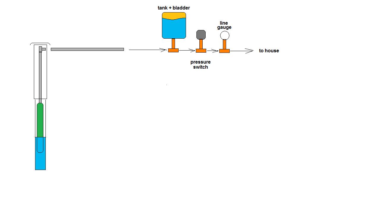

        the pump feeds to the tank through a T, actually two Tees. one side goes to the house off the tank, the other goes to the pressure switch that tells the pump when to turn on or off. You could add another T just to mount a gauge telling line pressure.
        the bladder in the tank will lessen the pump pulsations that MAY be detected by the pressure switch.

          well pump diagram - multistage submersible pumpClick image for larger version

            I'm working on my mother In law's house that we're trying to sell. It's in pretty bad shape. Once I got water I found the water heater bad. It's been there since 88 so I might as well change it too. Here's how I'm gonna pipe the tank we've been talking about. I'm reducing the pipe out to 3/4 and then the switch, then the gage then water in from well, then reduce too the hose adapter to the 1/2" in to the house. Increasing the line to the house would be way to much for me. If the new owner wants it he can do it. I personally haven't experienced a problem in the past with low pressure or flow so I guess 1/2" is sufficient.

              I think the way you said about your piping, your pressure switch will see the pump pulsations.
              so your pump will be turning on-off frequently.
              draw a picture using windows paint and attach the file.

                I got my fittings for piping the tank and finished it up. I reduced the pipe out of the tank to 3/4". There's two tees both with branch up. First one off tank has the switch and press gauge, second one has the line from the pump. Out of the second tee is a 3/4" ball valve with red bush to 1/2" hose adapter to house. It's all neat and only takes out about 18". I closed the valve and turned on the pump. It filled the tank quickly and with out the prior problems. Now I'll install the water heater when I can get some help. That things too heavy for me alone.
