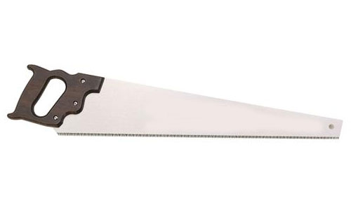

    Now, I take an ordinary hand saw:
    and, holding the blade of the hand saw flat against the good side of the kerf, complete the cut through the backsplash with the hand saw.
