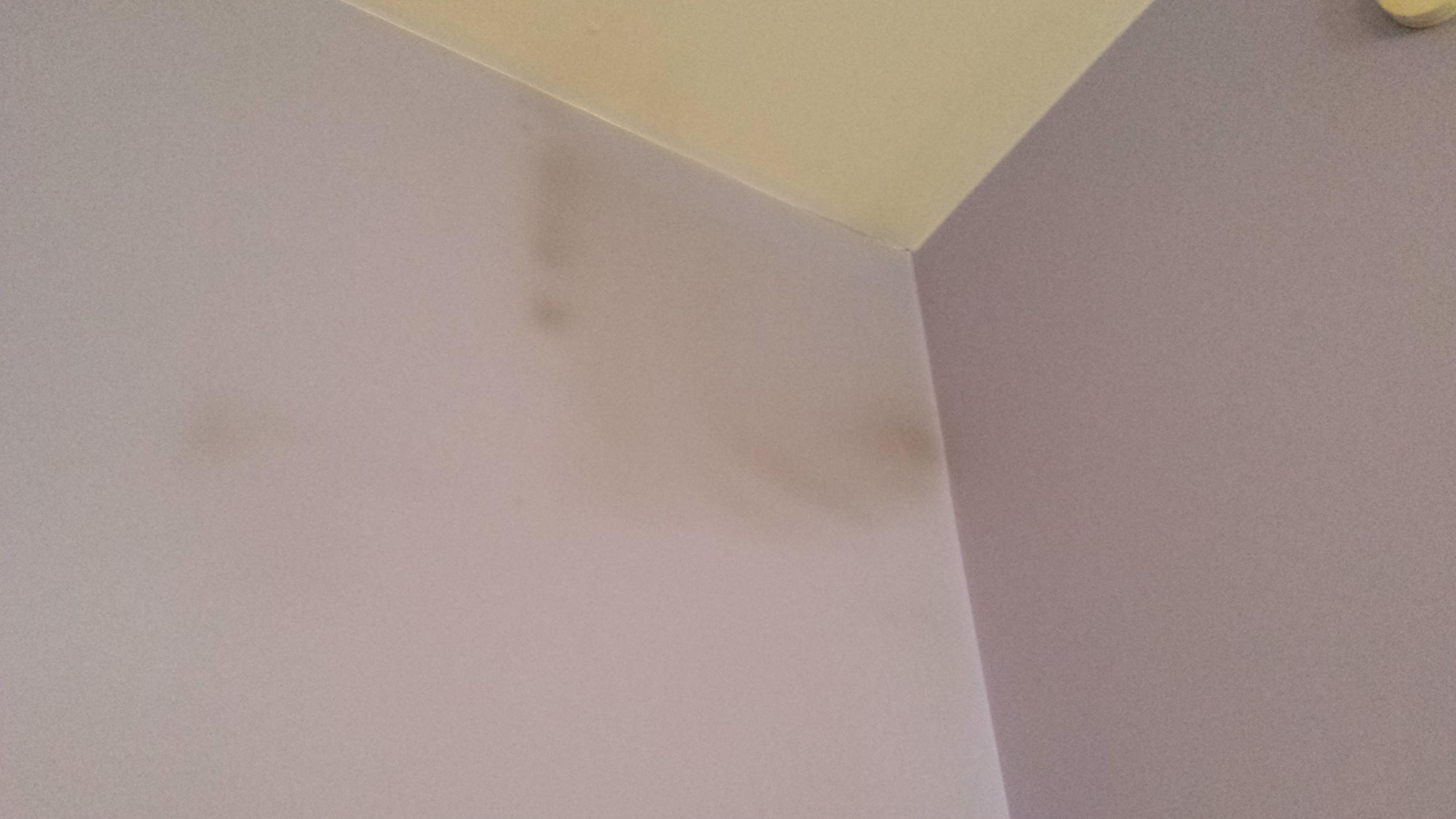

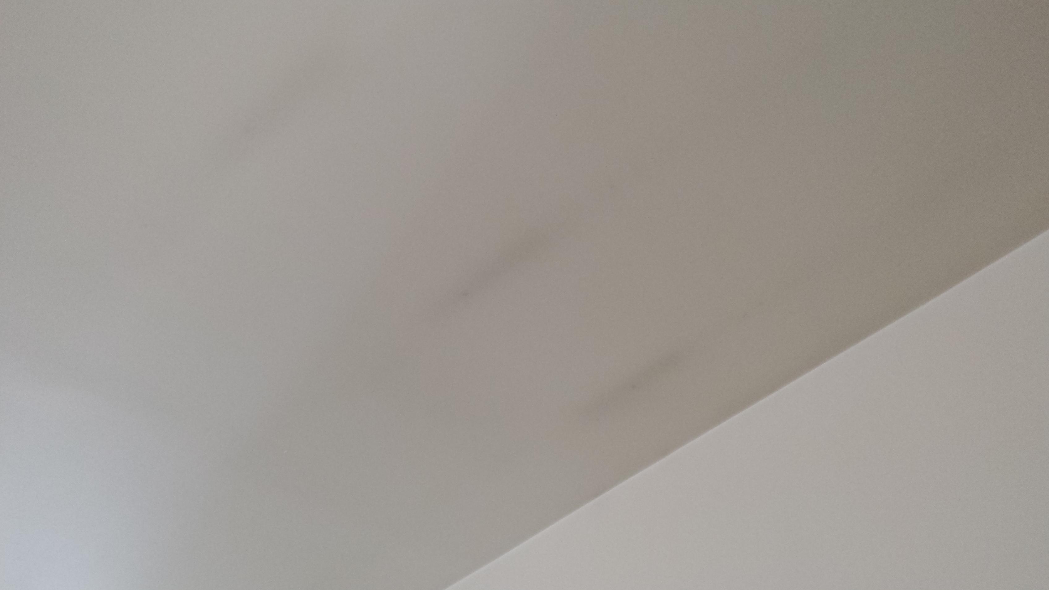

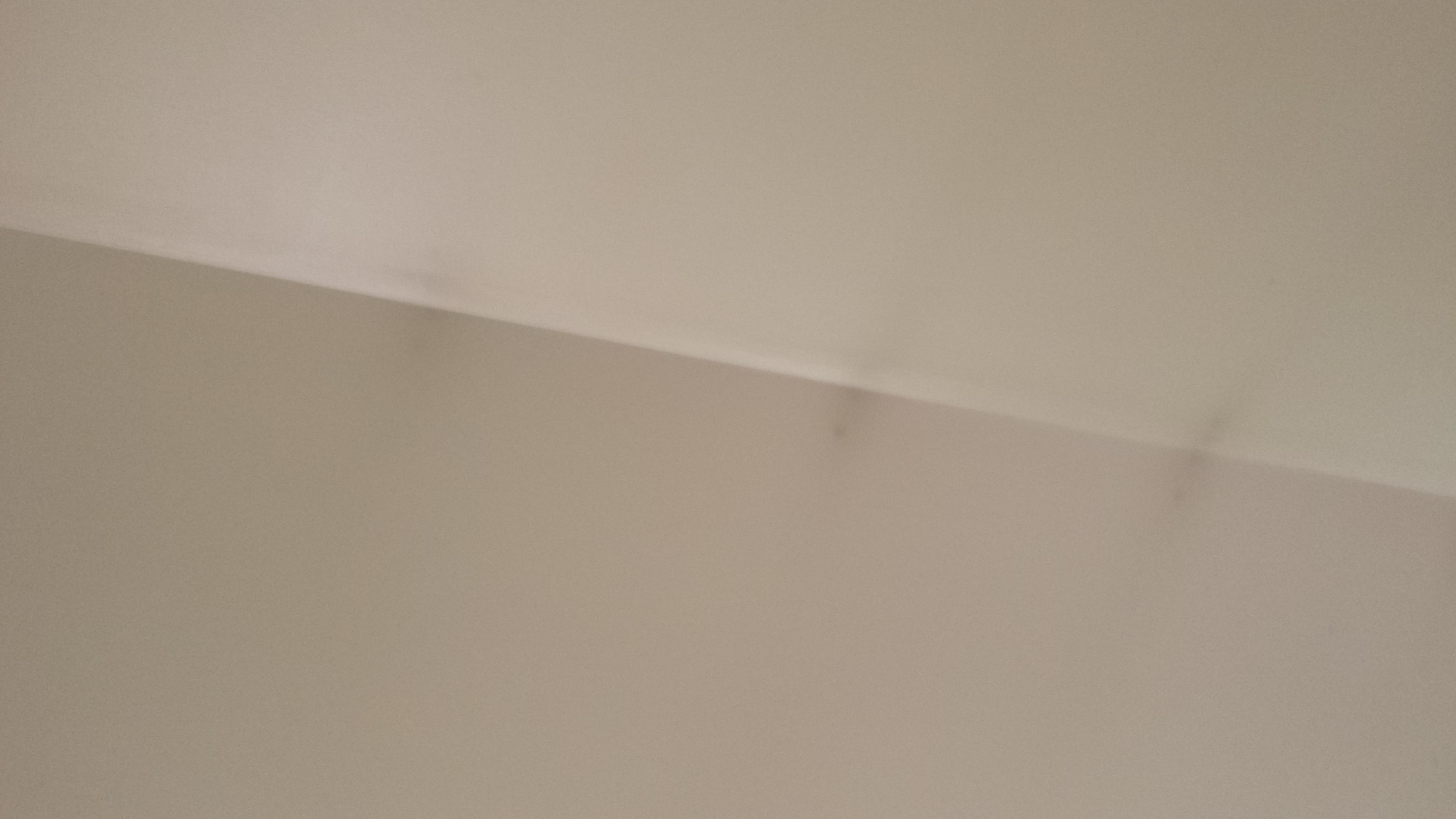

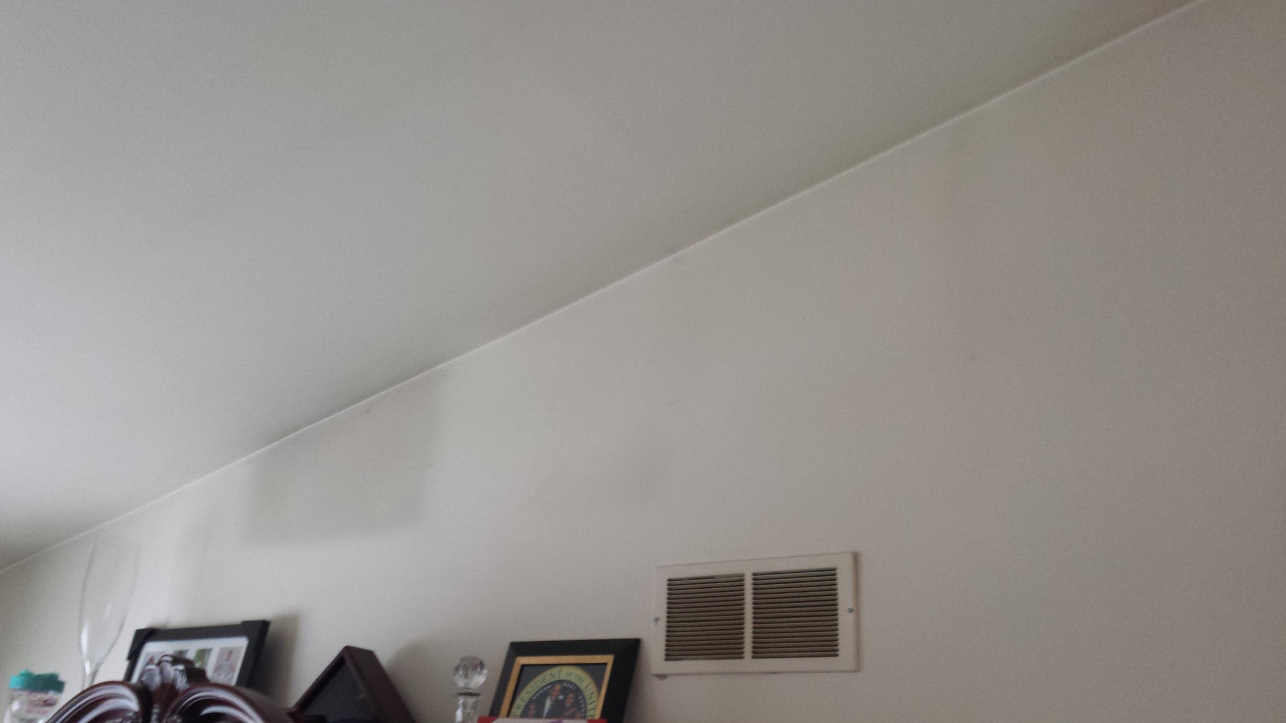

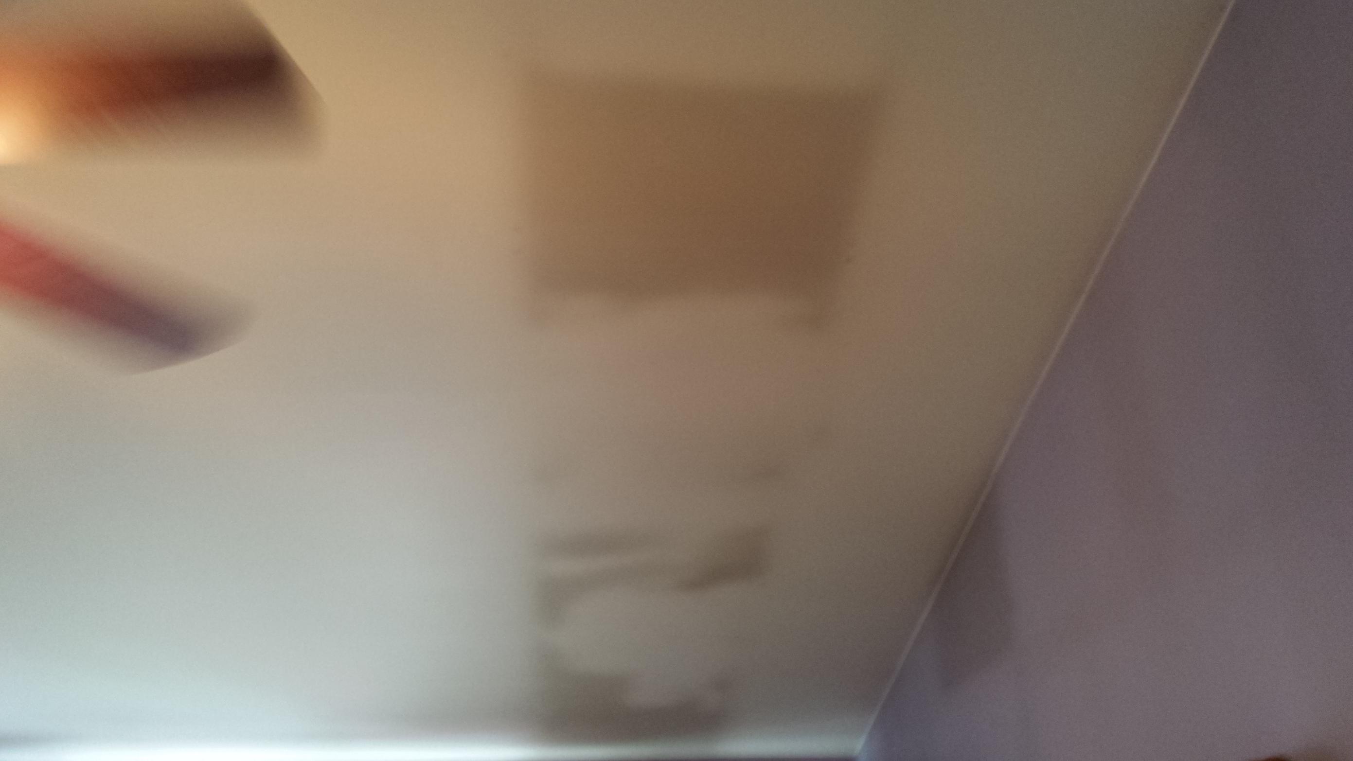

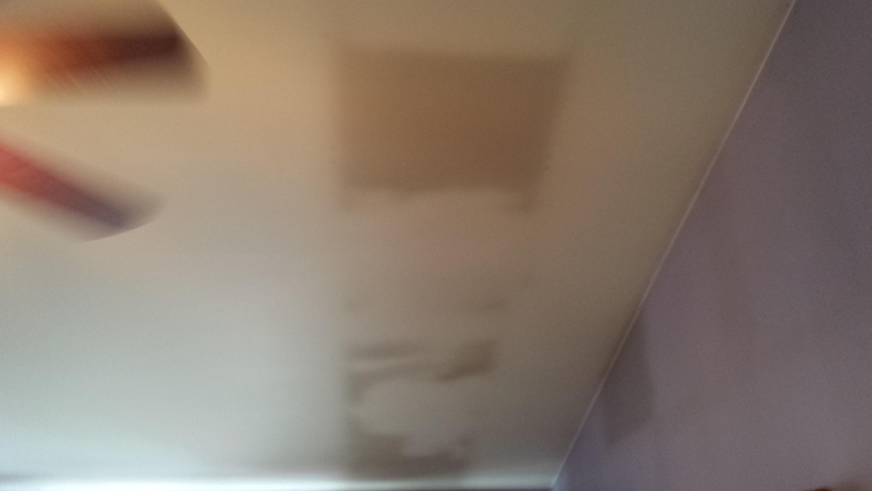

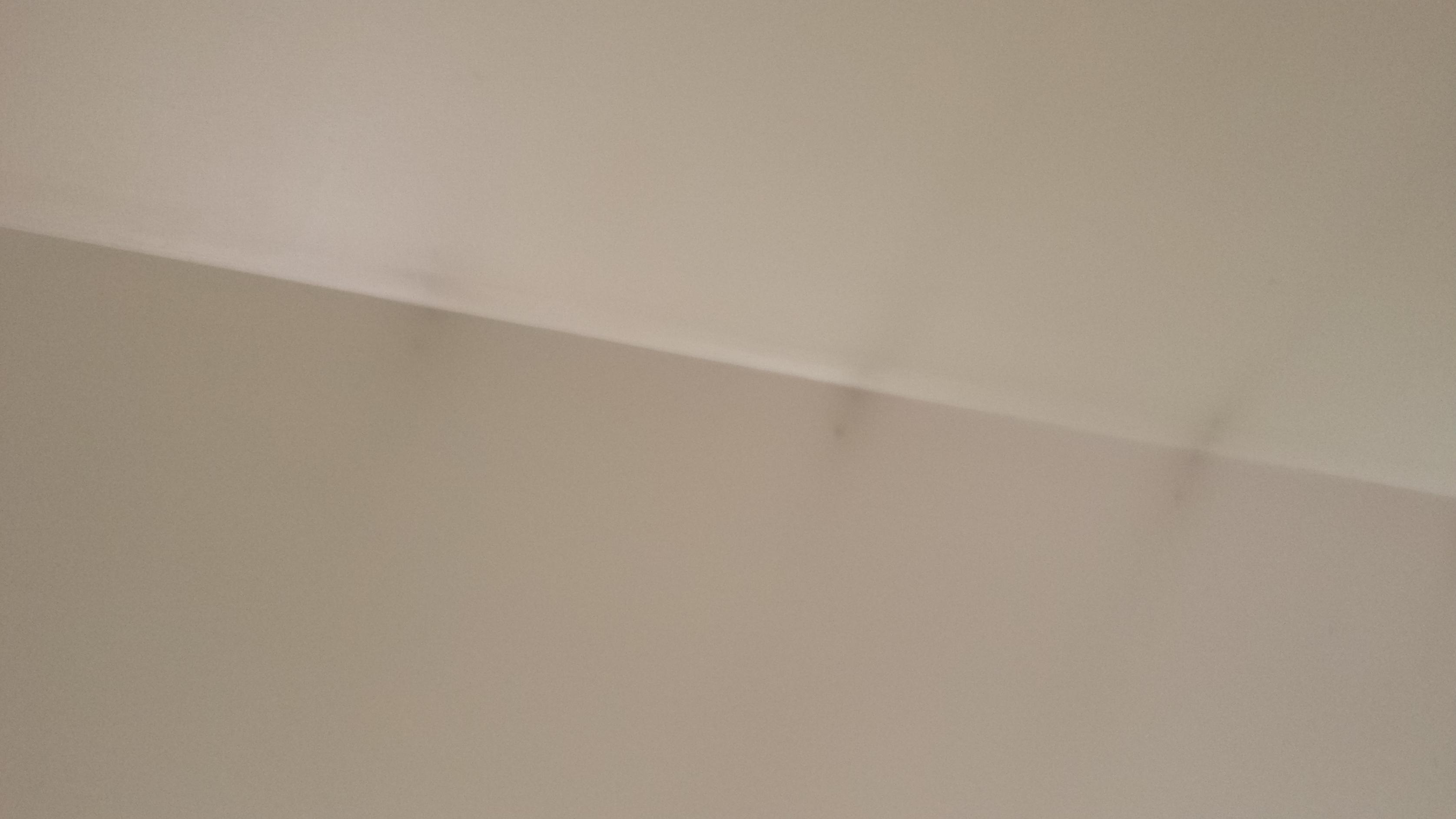

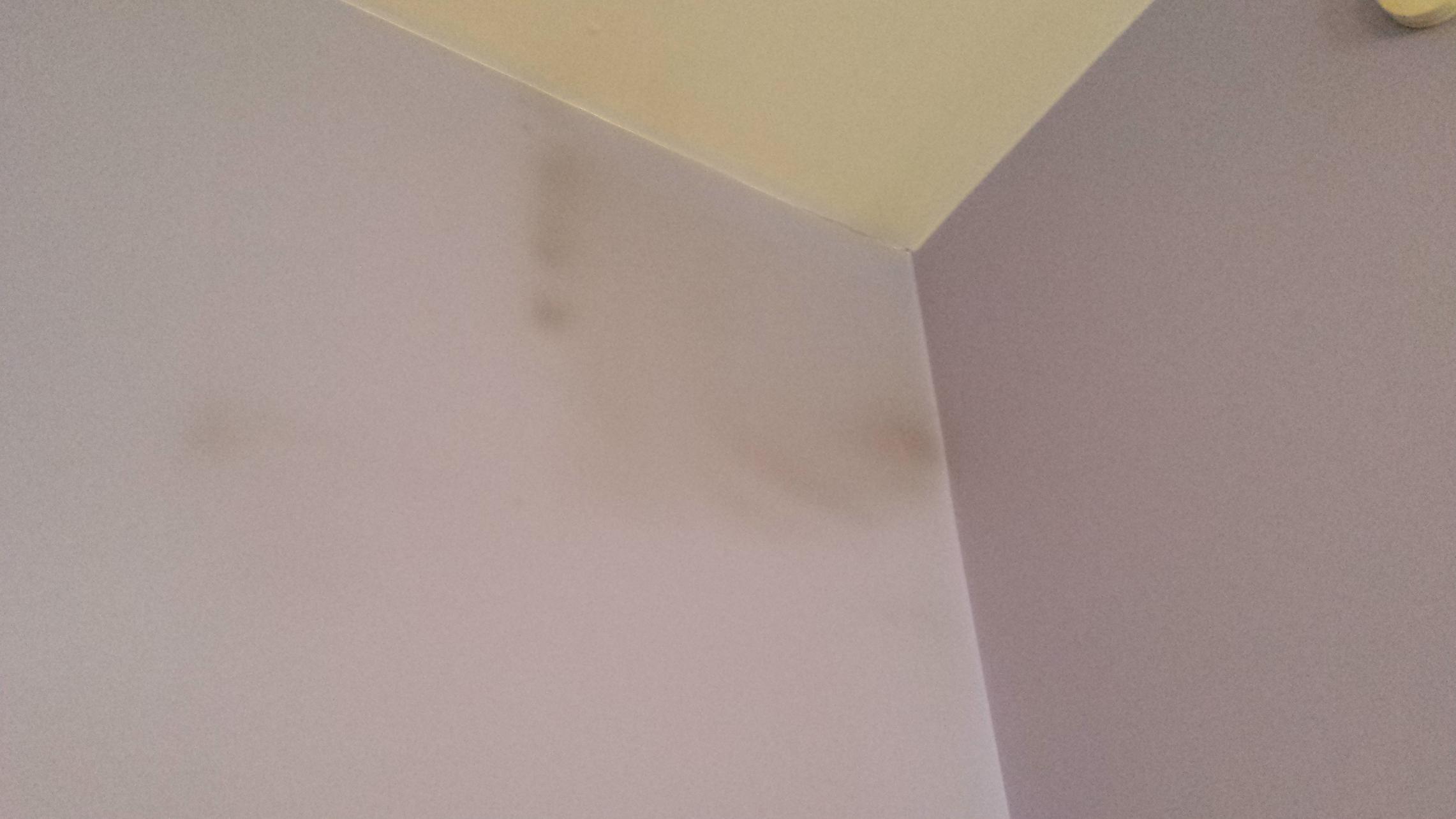

HELP! Strange markings all over the ceiling and walls.
Strange markings....
I had the same in my house. I found out that it's simply ions from smoke (fireplace?) that manage to gravitate to where the studs and joists are. Something about temperature differential between the masses of where the wood is at and where it isn't. One good thing: you definitely know where the studs are! Nothing to worry about. Wash it down and paint. -
Or, it could be a mold/mildew problem. Check for other signs of moisture buildup, get a dehumidifier if necessary. Check the gutters for rain management.Comment
