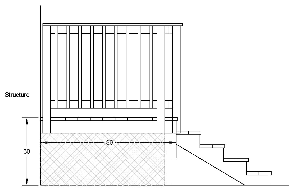

        The details on the deck itself: 5' x 15', from 26" to 30" high. ACQ treated lumber for all elements (I'd love to use composite decking, but it's not in the budget). 2x8 joists, 16" on center. I plan to put a railing on eventually, even though it's not required, mostly for appearance's sake and the fact that I have elderly relatives who would find the railing helpful to climb the stairs.

              When you say "bearer", are you referring to a horizontal beam that the deck framing sits on? I wasn't planning to use one of those, but to bolt the framing directly to the post. I built my last deck that way - ten years ago - and many decks I see around town are built that way. The design I turned in to the city didn't use one and was approved.
              Originally posted by pushkins
              End nailing is not a good method I believe your inspector is referring to "toe nailing" on a diagonal through the end of the joist into the bearer. I don't do this either, I always use joist hangers or galvanized "L" brackets on end joists. (Simpson do make a special joist hanger for end joists).
              Nailing through the rim into the end of the joists instead of using joist hangers. Again, built that way ten years ago and I still see it done. According to the guy at The City, that's permissible by code, but wouldn't define how.
              If you like exterior posts (doesn't use up deck space) then the DTT2 bracket is the best option, the other option is to mount the posts on the inside of the rim/band board this has the advantage of being able to bolt it to both the rim/band board AND the joist this stage is done right before you install the decking boards, the bad part is after you install the posts you will have to add blocking around the interior post to attach your decking to as the post will be surrounded by decking.
              Yep, exterior posts. What I plan to do is notch the post so that it laps the deck by half its own width. I suppose I'd bolt it on using the DTT2 over a spacer, then slide the decking under the edge.
              I've attached an image of part of what I submitted to the city. I'm just trying to work out what is permissible by code.
              Bill in Kansas City, MO
              Measure with a micrometer
              Mark with a crayon
              Cut with an axe.
                If the city approved your plans then your good to go, they have the final say regardless.
                End nailing is very old school, the nails will back out over time or simply become loose as the end grain they are nailed directly into opens and closes. If you still want to go that route I'd recommend using screws as they have much more bite.
                If your using a ledger bolted to the house then you cannot end nail the joists on the house end anyway so you have to either toe nail (3 nails either side each joist) or joist hangers.
                Again with attachment directly to the house (wood) you must flash the entire ledger, it would be wise to apply a blob of roofing asphalt over the ledger lock/ lag screw etc... heads as well before you screw down the decking planks.
