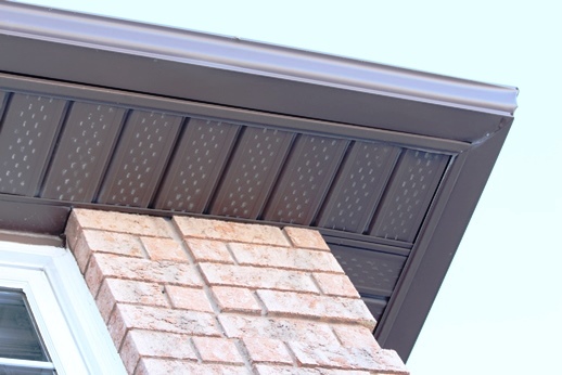

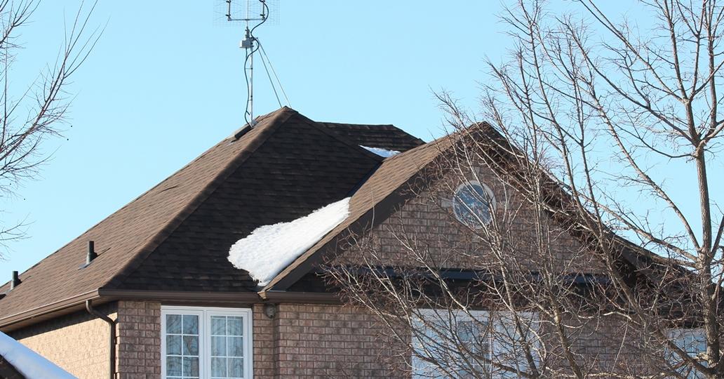

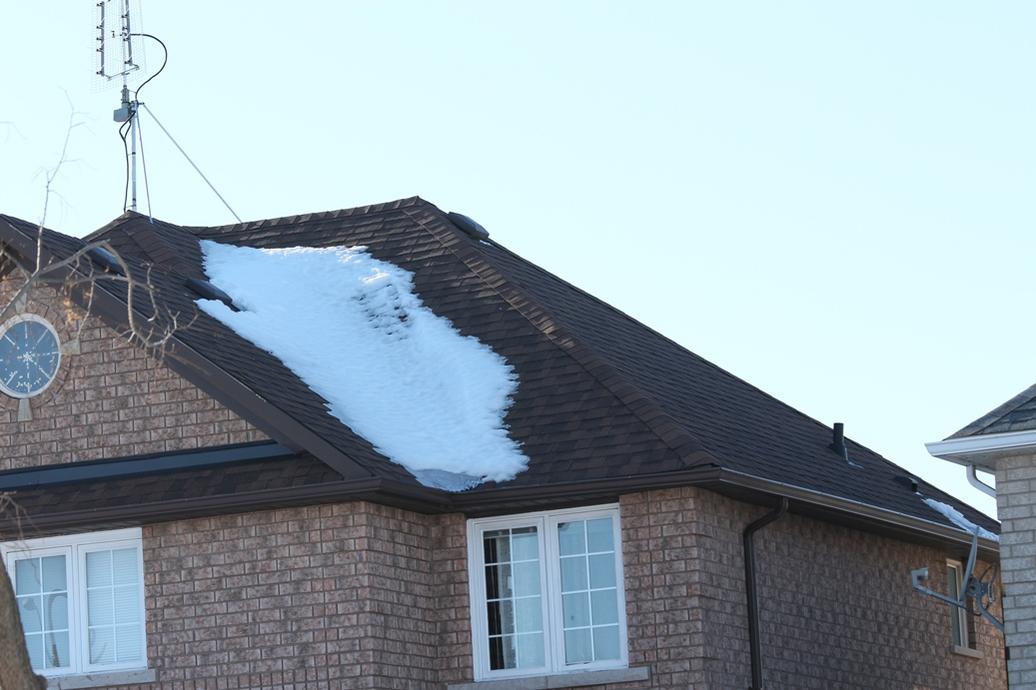

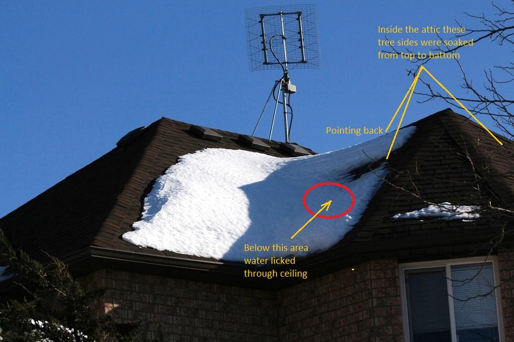

    For clarity I added some pics. The Top picture is low resolution from Google map; just give an overall image of the roof layout. Soffit looks ventilated. There is no ridge vent. All vents are regular, nothing was added.

        Good Pictures
        O.k, sorry I just saw the pictures you posted. I wonder how many leaves clogged the gutter from that tall tree? Also you may want to check the mounts on that antenna. With strong winds the bolts or screws holding it down could have come loose and leaked. Hope this helps.

          Leak
          It would be impossible to tell where your leak is by the pictures, but since you say it's wet top to bottom on the inside that's an indication the leak is up high since water wouldn't run uphill. I'd take a close look at the ridge cap and first few rows of shingles near the top of the roof. Also look for damaged shingles, any tabs that aren't sealed down that rain could have blown underneath or nails that may have backed out and punctured the outer tab of a shingle allowing water to enter. If your visual inspection doesn't find a problem area, I suggest you get a professional roofer to look at it. It can be very hard to determine where a leak is coming from sometimes since the water will get underneath the shingles and sometimes travel several feet before entering the house.
