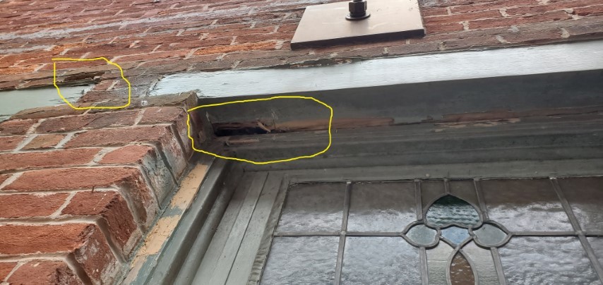

    In the above image there was a yellow circle on the right were I found insect damage above the transom. It's at a hard place to repair and I don't know the extent of the damage. My fist thought was to replace the header which should be much simpler than a window sill. However, if you look at the window header on the left side in the yellow circle you can see the brick is not in good shape. That brick came loose when I was tapping on the window header which like the door header is full of small black ants. The damage was done by carpenter ants. I've not had any success trying to kill the ants they just keep coming that makes a sectional repair almost impossible if I can't eliminate the ants. I've sprayed and I've used bait that they eat and they love eating it but they just keep coming buy the thousands. If I opt to replace the header how do I deal with the brick? I'm afraid if I take the headers out the brick will fall. I thought maybe I could take the headers out in pieces supporting the brick as I went but cutting them apart is the issue. What the heck would I use? Other ideas on how to approach this? I've already had some bricks fall out when I've taken out the window sills and they need remortared and replaced but they are supported by the bricks below. If I take out a header I could have not only a mess but serious danger.

    • The damage is indeed extensive and in a difficult area to repair, as mentioned.
    • The suggestion to replace the header seems valid, but caution is needed due to the unstable brickwork.
    • The ant infestation is not visible in the image, but given the extent of the damage, it's clearly a serious issue that needs to be addressed before any repairs.
    • Regarding brick stability, your concern about the bricks falling when the header is removed is justified. The image shows that some bricks are already in poor condition.
    • Your idea of removing the headers in pieces while supporting the brick could work, but it would require extreme care and possibly temporary support structures.
    • For cutting the headers, you might consider using a reciprocating saw with a blade designed for wood with nails, or an oscillating multi-tool for more precise cuts in tight spaces.
    • Given the extent of the damage and the structural concerns, it would be highly advisable to consult with a professional contractor or structural engineer before proceeding. The situation appears complex enough that DIY repairs could be risky.
    • The combination of water damage (evident from the deterioration) and insect infestation suggests that a comprehensive approach to repair and prevention will be necessary.
    I'd be very careful if trying to fix! Might be good to get a quote for repair to compare against your expenses. It might not be that far off. Let us know what other questions you have!!!

      I thought about a reciprocating saw but I can't figure out how I would be able to cut out even a section because the end of the saw has to go in and out there's no way to cut it except on a diagonal which would get into the door frame. The multi-tool would work to a point but I think slow going and I could only get so deep and then I'd be stuck again unless there's a 5-6" blade available and then I'd have to take out a block and replace it turn it into a cutting board. Maybe at the top of header where it is caulked I could slide in a piece of steel bar? I know the window header next to it is infested too so how many aren't comproised? There are 14 windows and 2 doors. I think the headers only lasted this long because they don't overhang like a window sill does.
      I hate to admit that I need help but...having to repair the whole brick wall starting at the top of the 2nd story would be a lot of work. Mason's seem to do new construction but repairing old is harder work becaause you have to remove the mortar and then put it back. I tried before to get an estimate and couldn't get anyone to even show up.

        Steel support isn't a bad idea at all, I'd research that. I know several of my windows have a flat steel bar above them to support. How old is the house?
        Sorry you couldn't get anyone to show up. The last few years it seems harder and harder to get help, especially in nonspecific or esoteric projects. I guess there is easier money to be made.
