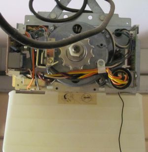

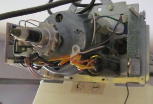

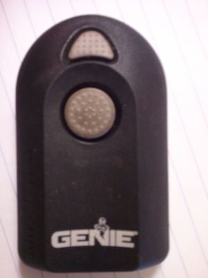

    Hi, I'm so glad to have found this forum! I need to program a garage door opener remote & it's a pretty old Genie garage door opener. I can't even find a model number & I've opened the thing up & looked all over it. It just says "Genie 1/2 HP Screw Drive". I've spent hours online this morning & I'm at a dead end. I've found plenty of advice online about pressing a learn button on the opener to reprogram the remote. But I can't find a learn button on the opener. I also found something about having to manually set something on the circuit board to match the remote control? I don't quite understand that option. So can anyone help? I'm attaching pictures of the opener. Thank you so much!

    The code for your opener is the red box @ the left light bulb and the remote you show in pic will not work with your opener. Get a universal remote or a Genie 912 remote.

      Thank you - you're exactly right, of course. Just a couple days ago, I finally found a friend who had seen one of these before. And I also found the older remote that went with this opener. He got the code from the opener, where you said it was, & programmed the remote for me. It's nice to have it working after so long. Thanks again!

              If you have a Genie as in the pictures in the first post of this thread. Look @ the second picture and you can see the dip-switches on the left behind the light bulb. You will need a Genie GT912-1BL 9/12 Switch Remote or Liftmaster 375LM Remote Clicker Universal Remote
              Some older Genie as the Pro88 has an external receiver (look some like this) and when you open it up, you will see the same dip-switches.
              Oh to program the remote, match up the switches in the remote with the switches on the opener/receiver.
