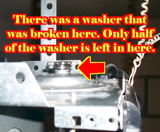

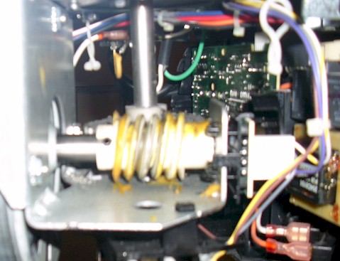

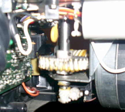

        I opened the garage opener but the gears did not look warned out to me. I took pictures as seen below. Can you please tell me if you can tell by just by looking at the pictures if I need to replace the gear/sprocket? There was also a washer that was broken as seen in the picture. Thank you.

          Most likely it's NOT a broken washer, but part of the bushing at the sprocket and all the debris from it is all the black stuff on top/inside the big white gear.
          The two smaller gears you see at the bottom in the second picture are what that control the limit switch, with the wear of the bushing and you connect the door will pull the gears apart and not engaging so the opener don't know when to stop going up and/or down.
