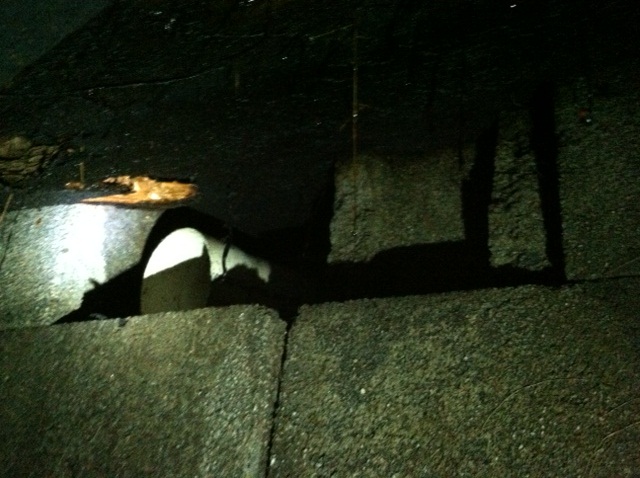

ID:	87184I did some more digging. There is a pipe coming into it. Around the side of the house there is a drain in the sidewalk, never knew where it went. I tried to run some water through it and see if it comes out here, but it does not seem to drain very fast (clogged?) and I can't tell if it goes here. This is also near the current septic tank, then again I imagine there would be some smell to it. So this is a 4' x 4' block structure, no bottom, about 2' in height with plastic and wood on top that has rotted, no mortar on the blocks. I am thinking it was some part of the drain system. Would I need to do something with the pipe or can I just fill in the hole? This is close to a hill so presumably I could divert the pipe to the woods behind the house. If I filled it, should I dig out the top or can I backfill through the opening? Thanks for the input.

            It sounds like a drain system of some sort. Filling it in might be ok, it all depends on what you intend to do with that spot in the future. If you plan on digging there for some other reason later on, you might want to remove the blocks first.

                I exposed the pipe from above and found it was a drainage type, the ones with all the holes in it. Probably full of dirt at this point since they did not sleeve it with anything. Since this was behind the house I got several loads of street sweepings from our town and filled it halfway with that, then topped it off with fill dirt. Still need to get some topsoil and seed, but we've had some torrential downpours and doesn't seem to be caving in anymore. I expect it will still settle a bit but should be ok.
