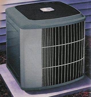

2. Vacuum the slats (also called fins). This removes any debris that may be blocking air flow from the unit.
3. Clean inside the unit by unscrewing the grill fan and removing from the unit. Use a vacuum hose to gently remove any debris from the interior side of the slats. Be careful not to use too much pressure as this could damage the slats.
