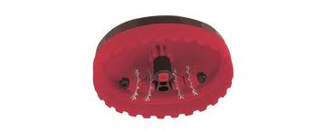

Use the wallpaper scouring tool (pictured below) to create small holes through the paper.
Next, apply a wallpaper stripping solution that will soak through the holes to release the glue.
