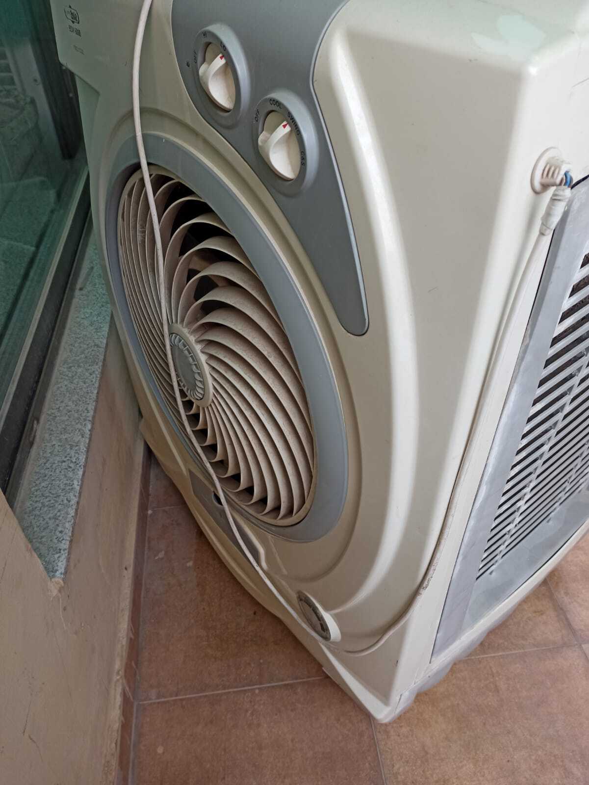

    Do you have any pictures? What brand is it? Water coolers are built in many different ways so it probably matters how it is configured.

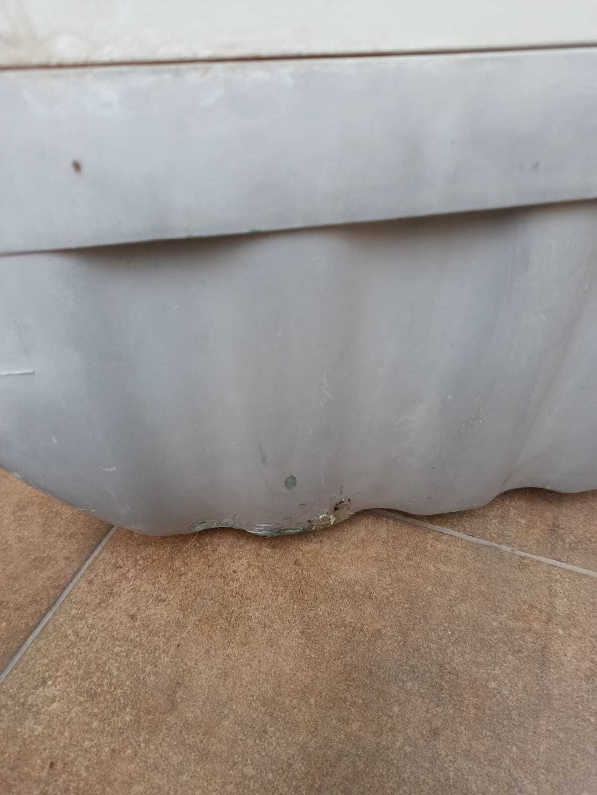

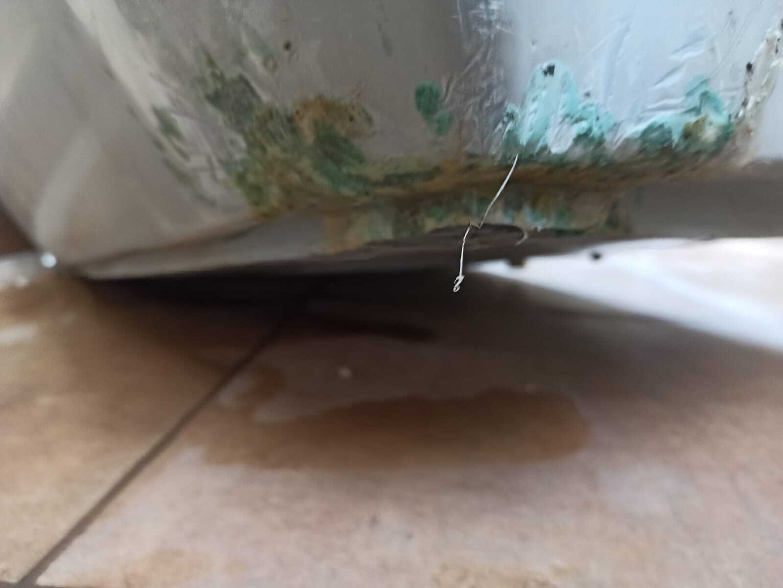

      I got these pictures of the cooler sorry missed the brand name. As you can see it have a big tank which I got temporary fixed. I am saying temporary because I called someone to take a look at it, he removed the tires and tried to fix it by melting a PVC pipe (not sure about the material of the pipe but that is what it looked like) over the broken area. You can see the green stuff in the picture, I think that is the melted pipe. I am not sure but I think he also attached some small metal pieces.
      Do you think this would last long?
      Due to the weather, I am not currently using it.
      • TinyTool
        • 357
        Interesting. From the looks of it, the technician seems to have used a quick fix by melting some kind of PVC or plastic material over the damaged area and reinforcing it with small metal pieces. The greenish residue could be corrosion if metal was involved, or just leftover material from the repair process. While this kind of patch might hold for a while, it’s unlikely to last in the long run, especially since the damaged area is near the bottom of the tank where it’s under constant water pressure. To make the repair more durable, you could reinforce it with a good waterproof epoxy or sealant designed for plastic tanks, but make sure to clean and dry the area first. For a more permanent fix, plastic welding with the right filler material would work much better. That said, if the cooler is old or starting to show signs of wear in other places, you might want to think about replacing the tank altogether to avoid future headaches.
