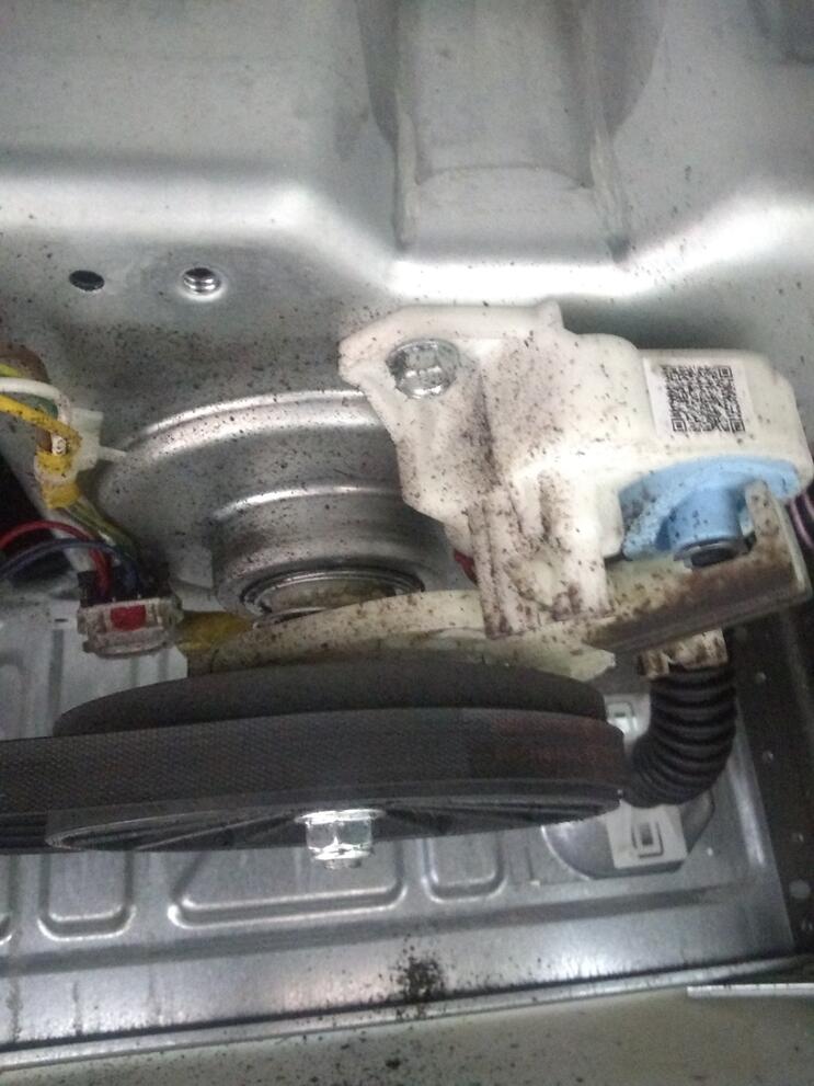

    Bearing like noise as machine starts to slow down from spin cycle, The noise decreases as tub slows down to a stop. No noise when actually on spin cycle or any other cycle just after spin finishes and tub is slowing down. Under side of machine, belt and floor is covered in a black grease like substance. Can not duplicate noise by spinning tub by hand

    Tried hand spinning machine with bottom belt cover and with belt both on and off. Unable to duplicate noise. Bottom smooth pulley has a lot of side to side play. Pulled off pulley and same play in actual shaft side to side.

    Hi there!
    From what you're describing and based on the pictures, it really sounds like the tub bearing or shaft assembly might be going bad.
    The black grease-like substance splattered on the bottom and around the belt area is usually a sign of a failing bearing or seal. Over time, as the machine spins, grease gets thrown out, and that seems to be what's happening here. Since the noise only happens as the tub slows down and not during the actual spin, it's a strong clue that there's play in the bearing or shaft. That play becomes more noticeable when the spin slows and the tub is coasting to a stop.
    You also mentioned there's a lot of side-to-side play in the bottom pulley, and the shaft still moves even after removing the pulley. That shaft should be pretty solid. If it's moving, the bearing is likely worn out or the internal part of the mode shifter or transmission is starting to fail.
    Just to narrow things down further, has the washer ever leaked or dealt with a lot of heavy or unbalanced loads? And how old is the machine?
    If you're handy with repairs and it's out of warranty, you might need to replace the mode shifter or possibly the full transmission, depending on how GE built this model. Some GE washers don’t let you replace just the bearing without doing a full assembly swap.

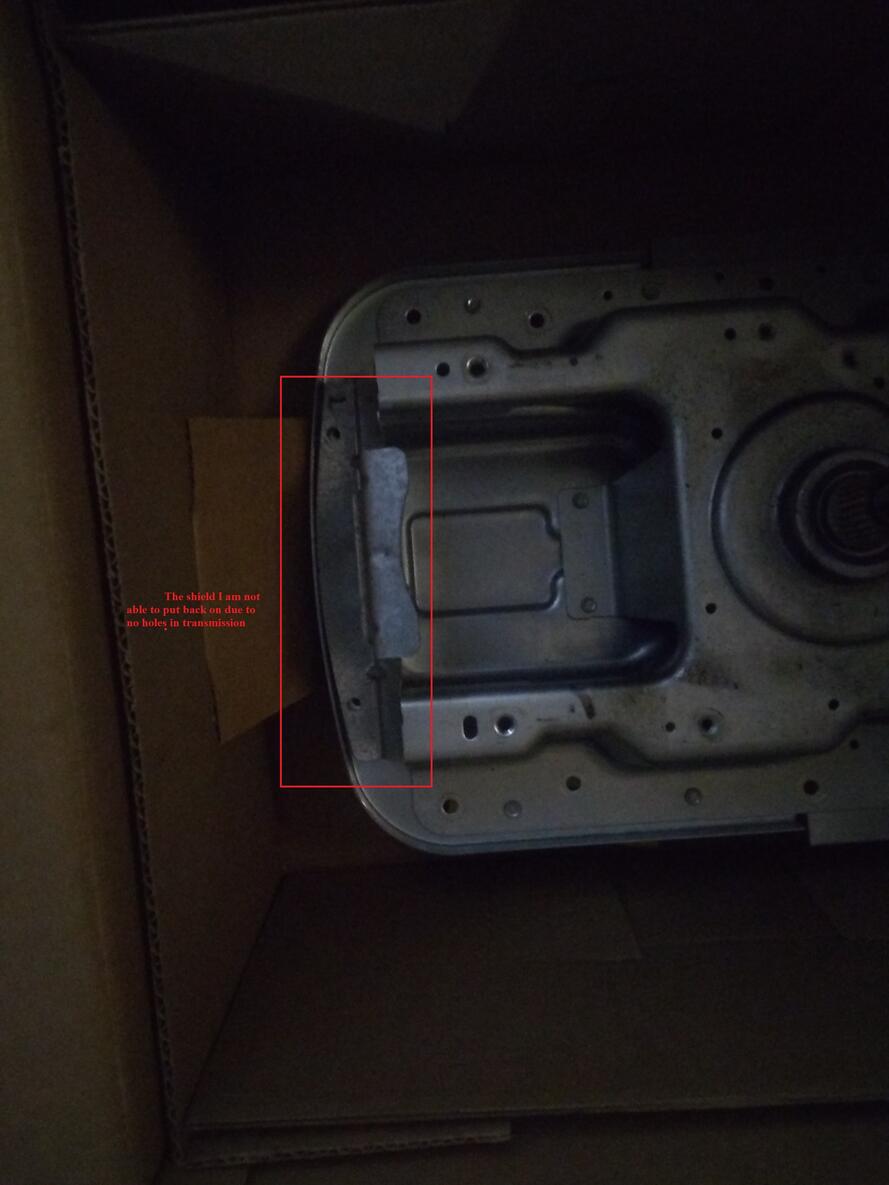

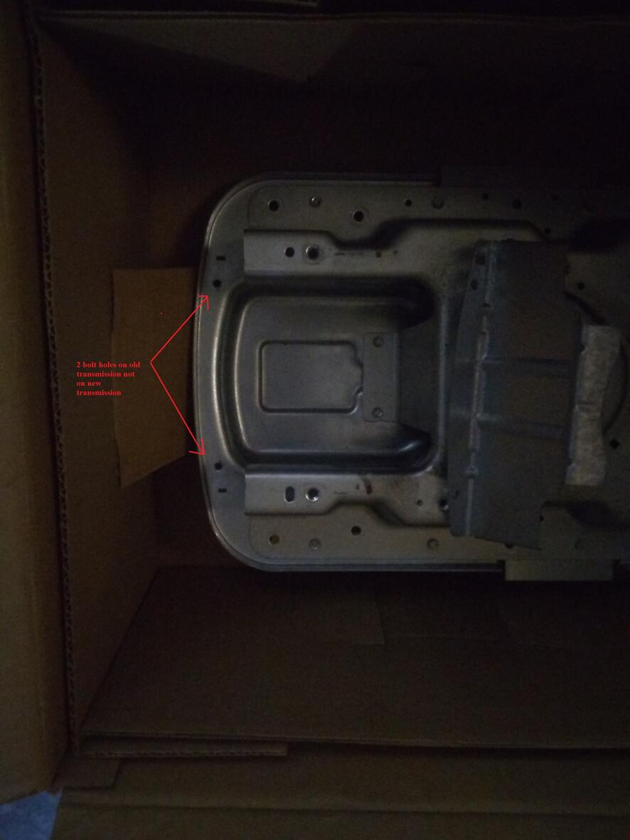

          Ok the parts are in and the first load has run and no more noise! I do have a question. There was a metal shield that was on the end of the transmission enclosing the motor but the new factory transmission did not have any holes in it to reinstall it. Does it matter? Not sure of its purpose but here are a couple of photos to better explain where it was on the old transmission.

          • machinist
            Moderator
            • 386
            Thanks for the update, and really glad to hear the washer is running quietly now.
            About the metal shield, it was most likely there just to offer some extra protection for the motor area, maybe from splashes or any grease from the old transmission. Since the new transmission doesn’t have holes for it, GE probably changed the design and decided it wasn’t needed anymore.
            If everything fits well, runs smoothly, and nothing seems exposed or at risk, you should be fine leaving it off. It’s always a good idea to keep an eye on it for the first few loads just to make sure everything stays clean and dry underneath.
