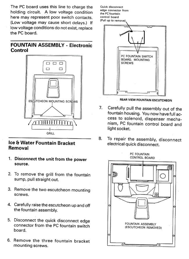

      where is the dispenser control board located?
      How do I go about replacing the board? I'm moderately handy but don't know where it's located or how to get to it.
      • Dan O.
        • Sep 2003
        • 2167
        Dispenser access
        Both boards should be behind the dispenser cover. The attached image may be for the dispenser used on your model.

        • maque
          • Jun 2013
          • 5
          Thanks
          Thanks Dan for all the help. Now I'll give it a shot.
          • maque
            • Jun 2013
            • 5
            Done
            Repair was successful. Thanks again Dan.

              • maque
                • Jun 2013
                • 5
                PC board
                And oh yeah.... the problem was the PC Fountain Control Board.
