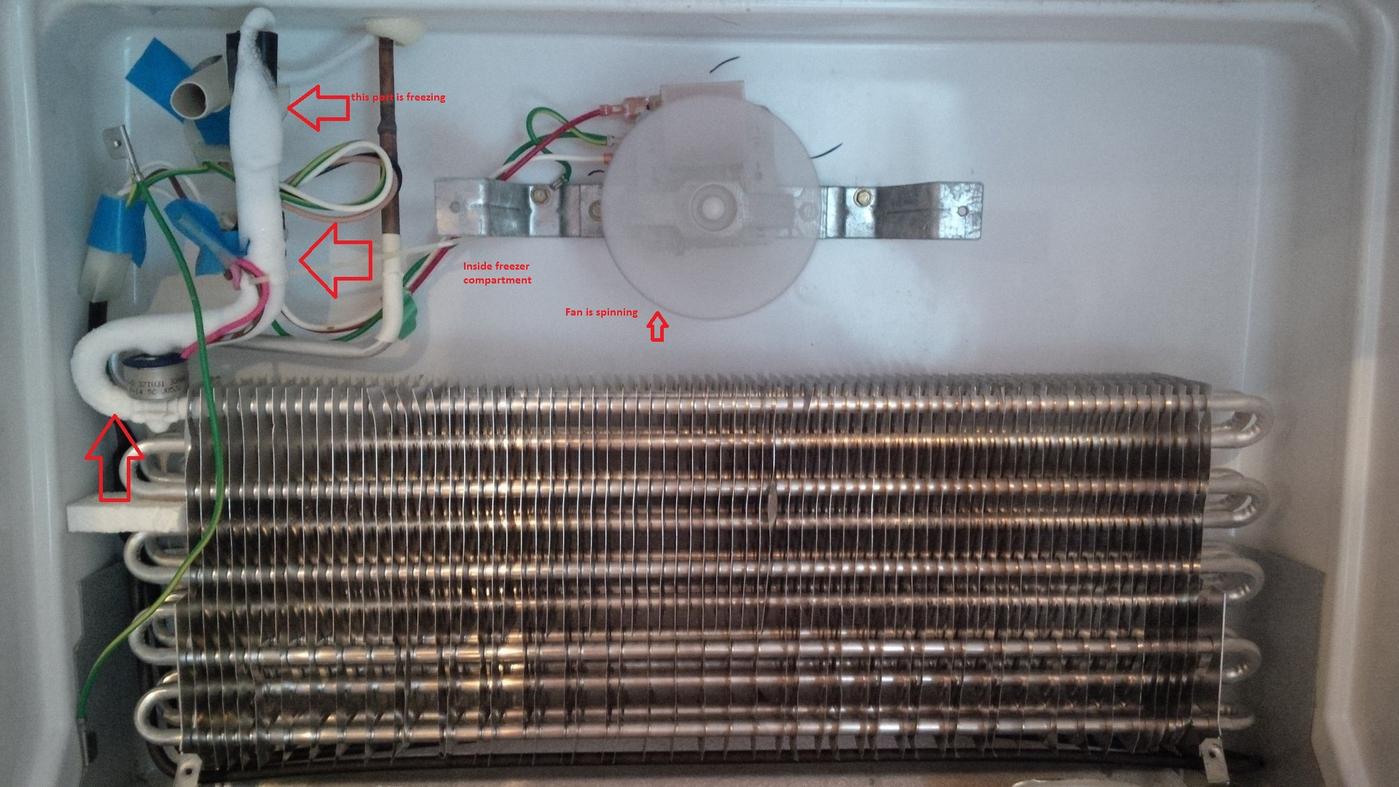

    Hi Everyone,
    my fridge won't cool anymore, i left it unplugged for a days and now i'm trying to troubleshoot the issue. i plugged it in overnight and it wasn't cool in the freezer compartment. What i do know the compressor and condenser fan is on. The evaporator fan in the freezer is on too but doesn't cool.
    This pipe to the top left is nicely chilled and frozen over. Any suggestions on what i should try first? If it is stuff in defrost mode, shouldn't the compressor and condenser fan not be running? Thanks for any suggestions in advance.

    The only partial frosting indicates a refrigeration system problem (see the following link). There is nothing you can do for it. It will require a professional to diagnose and repair although if it is no longer under warranty, will probably not be worthwhile to pursue. A refrigeration system repair usually starts at $150+
    LINK > My frost free refrigerator is not cooling properly. What might be the problem?
