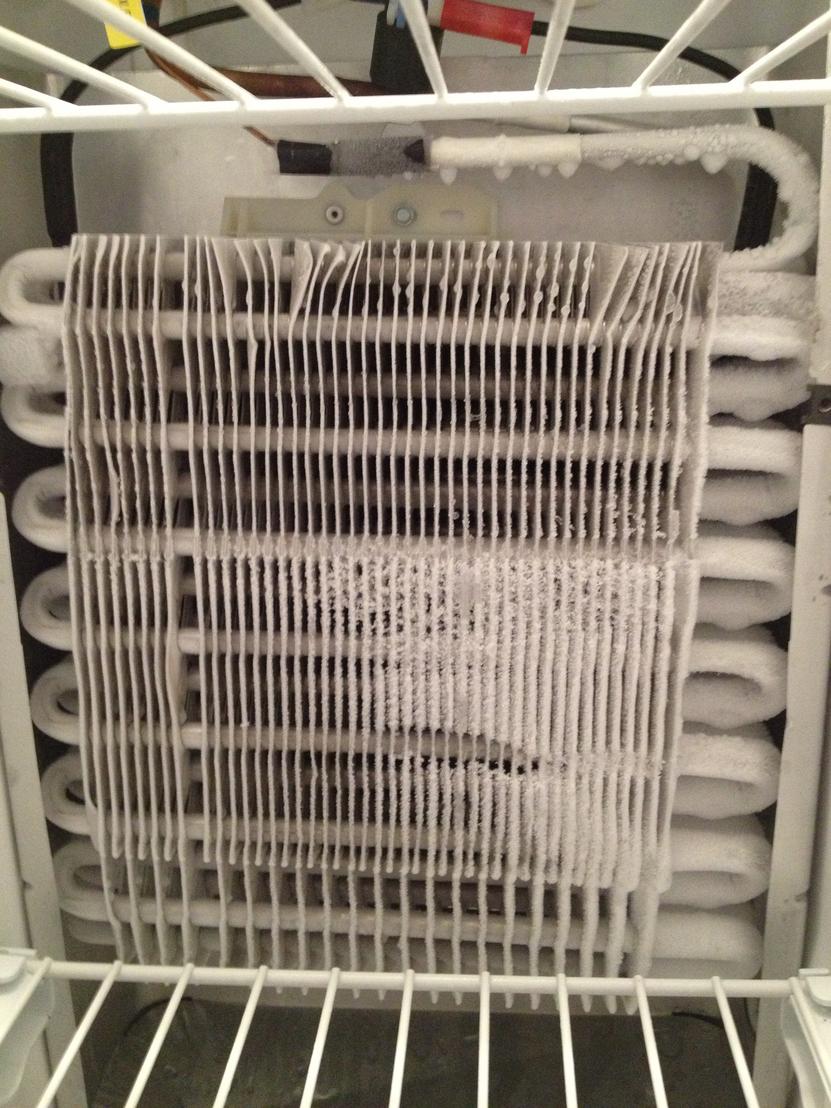

    Picture of the evaporator coils.... they are not all frosted over.... Click image for larger version

    Any advice please? I was thinking the main board but not sure...

    [the evaporator coils] are not all frosted over
    That would usually point to a problem with the refrigeration system or most likely with your particular symptom, the compressor itself.
