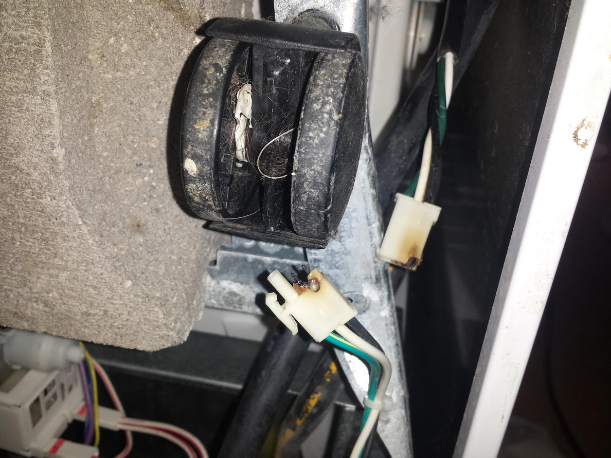

GE Portable Dishwasher Model # GLC4400R100WW No power.
  • Superstimpy
    • Nov 2014
    Think I found the problem but not sure if it's something I can bypass or not. Picture included. Any suggestions?

    Sorry I was off on the model #. Its actually GLC4400R10WW

      A connector should usually be able to be bypassed without a problem. Getting a replacement connector and proper wire terminals from GE is extremely unlikely IMO.
      What does the wiring go to and would it ever need to be disconnected in the future? If not, I myself would likely cut and join the appropriate wires together individually.

        Done and works great. It's the power cable directly connected to plug in. The washer is stored in front of a heat vent. Maybe that was the issue. Found a new spot for it.

          Poor connection
          That is very unlikely. Failures like that are usually due to a loose connection which generates heat. Either the terminals inside the connector were not attached to the wires properly or the connector was not connected securely together during assembly or became loose during appliance installation or subsequent maintenance.
