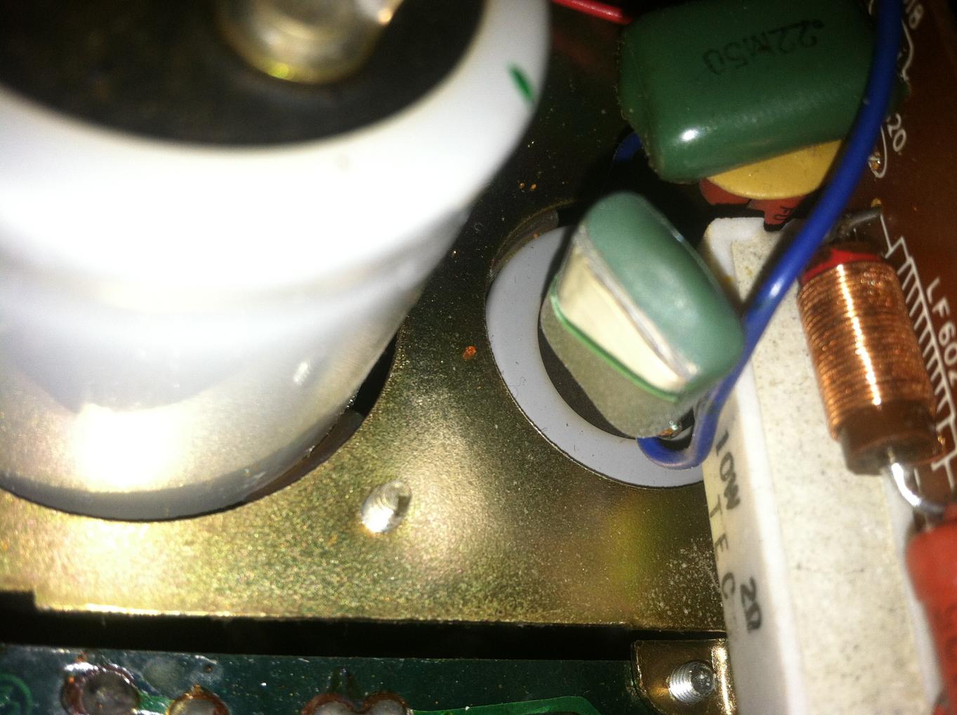

Also, attached to the leads on the smaller filter cap is what looks like a smaller capacitor. When I found it, I noticed the green casing was split. I flaked off the casing and it looks like the aluminum shell underneath is in tact, so I'm not sure whether to replace it or not. Here's a pic

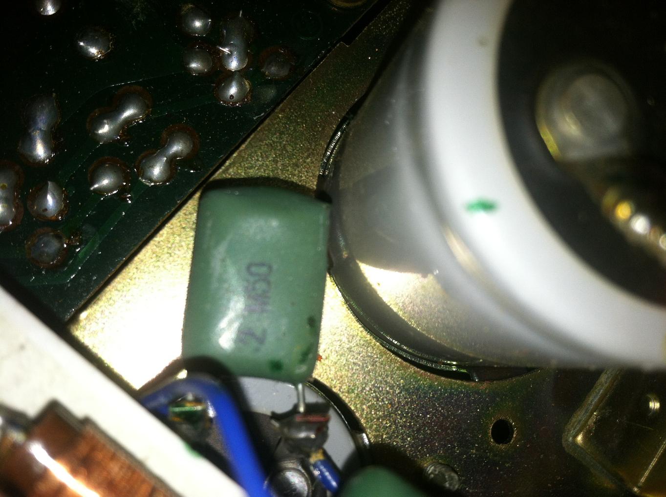

and one of the other side

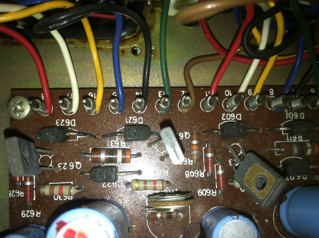

I also found a row of diodes that have black "stuff" on their leads. I don't know if they were made like this or if it's scorching and they need replaced. Here's a pic:

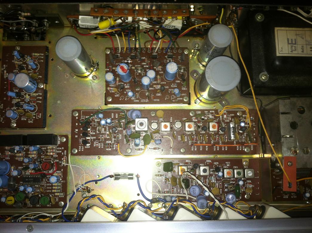

Well I think that about covers all the questions I have concerning this project. Any input and advice on this is greatly appreciated! And for good measure, here's a pic of the innards from the top:
