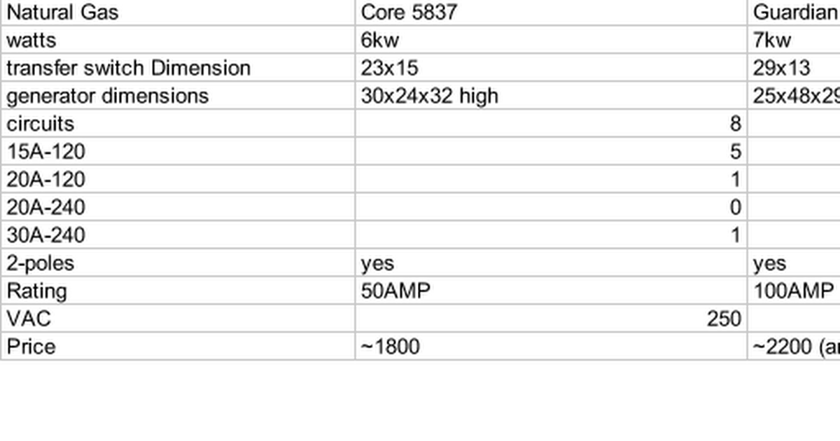

    I have narrowed this thing down to 2 Generac units (NG): Core series 6kw (5837) and the Guardian 7k(5870).
    I have a spread sheet I created to help me choose:
    My question(s)"
    1. my a/c is on a 30A breaker. It is a larger 2-bay breaker in my 100watt panel. Can I assume this is 240?
    2. If I choose the larger 5870 over the smaller footprint core, which has an additional 20A-240, should I choose the smaller unit so the 20A-240 doesn't go un-used?
    3. Will either unit work for my house to supply some of these circuits or will the smaller core be too small based on the electrical capacity of the unit?
    core:
    5870:
    thanks in advance
    standby generator(s)
    the 6kw unit will produce 25 amps to the load with occasional peaks. the 7kw unit will produce 29.16 amps at its top end. what you refer to a double bay 30 - I guess you mean a 2 pole breaker for the a/c. the breaker will either have an internal common trip [one handle] or two handles with a tie-bar in between, even though the breakers are physically riveted together.
    Look at the current draw on the a/c nameplate for running amps. if yours has, let's say a fla of 22 amps, then that leaves 3 amps for incidental loads [total 25 amps] or 7.16 for incidental loads on the 7kw unit. mind you, as voltage goes down [240 to 120] your load amps increases by 2X.
