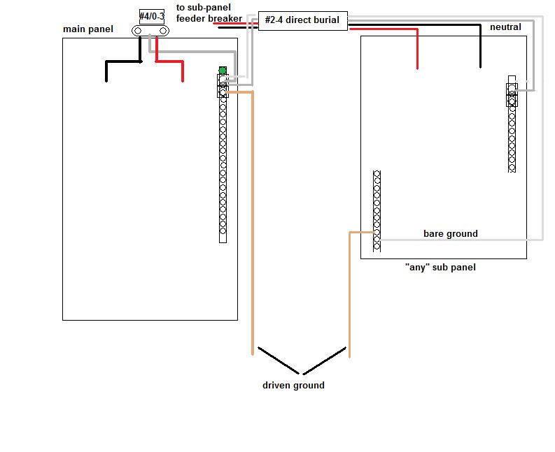

                SE panel & sub
                I drew a diagram which should help show you what I'm talking about pertaining to the neutrals and equip groundsClick image for larger version

                  what is the 4 wire going to do that a 3 wire cannot? at the sub panel...thanks for the info,i am learning
                    sub panel
                    you ran the four wire! I would have run a three wire, myself and used the driven ground as an equipment ground. the reason for the separate ground is to prevent objectional currents from energizing the panelbox which would happen if the neutral was bonded to the chassis metal. ideally the current path is from the hot, through the load and back to the neutral, which connects to the center leg of the transformer at the pole. the aux ground is there for fault currents, leakage paths if a motor winding grounds out.
