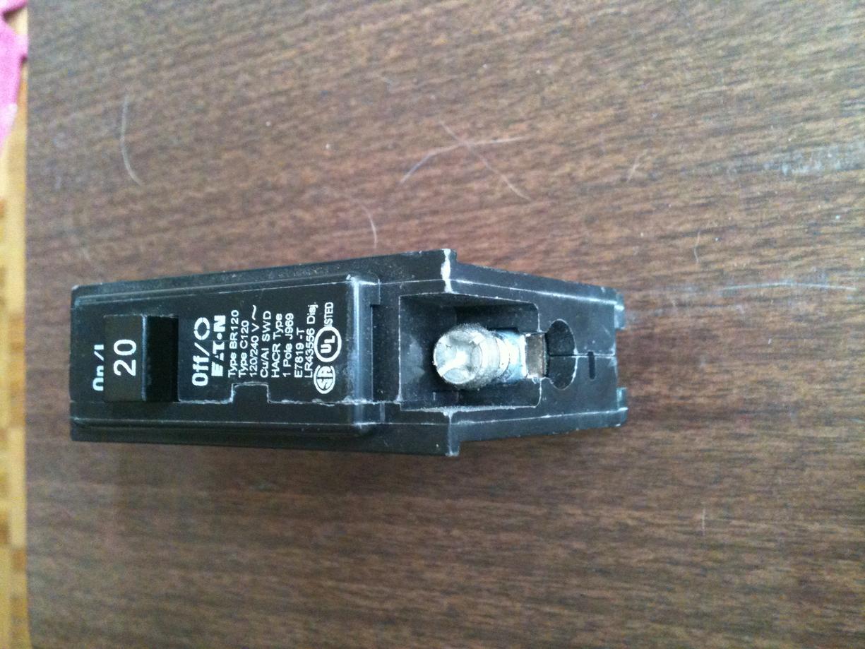

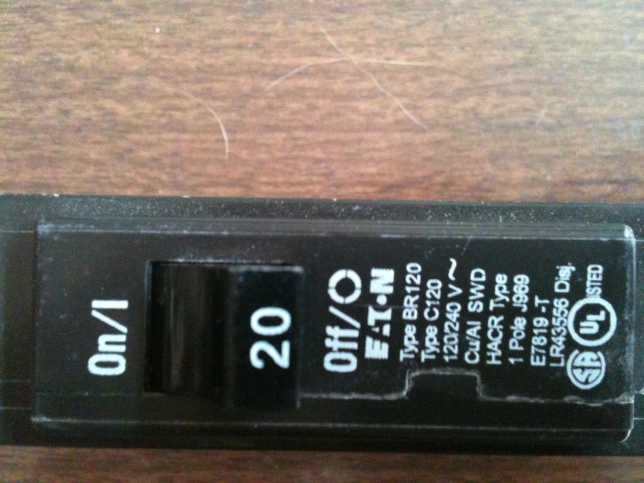

          So I have the "armoured cable" which I believe is the BX you were referring to earlier, the box, switch, breaker and even a few feet of thermostat wire while I was at it. The breaker looks like it will fit with no issues, but I have posted a couple pictures. I figure a knowledgeable point of view would be nice in case Eaton isn't a good brand or something. Let me know what you think, thanks.Click image for larger version

            those two breakers are Ok. thing is their usage in your panel is no good.
            you need a two pole 40 for your range within a half sized breaker;
            the 20-40 and 40-20 will give you this configuration.
            print out your panelbox pictures and take them with you next time you go to the jobber.
            twin half sized breakers are ok, full sized breakers won't do.
            take 'em back!

              Oh, I guess I should have mentioned that they didn't have the 40-20 amp breaker as you suspected they wouldn't. I opted to go with a single 20 amp breaker that would go in one of the two empty spaces at the bottom of the panelbox. I figure that would save me the hunt for the 40-20 amp and I wouldn't have to take that setup out.
                #22
                breakers
                Oh! Ok! I didn't see those open spaces - my mistake. Then you're good as gold!

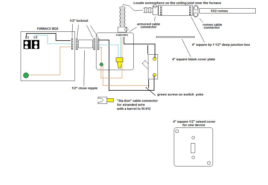

                  Great. In that case, I just have a few more points to clarify if you don't mind, then I should be able to get this done. First and most important would be how to connect the white wire to the strip in the panelbox. If the power is still on, is it safe to just insert the wire and tighten down the screw? Second, on the new breaker, it looks like it is setup to take a much larger wire that I need, is it ok to just tighten this down on the wire I have? Third, in the box for the switch, there is one screw for grounds, do both the ground from the panelbox and the ground going to the furnace get connected to this one screw? Fourth, the switch has 2 connection points. If I understand the your earlier explanation, the white wires get connected within the box, then the black from the panel box goes to the top of the switch and the black wire to the furnace goes to the bottom of the switch? And finally last, the ground wire coming out from my new furnace is an insulated wire consisting of strands, where the ground from the BX is bare and solid. Is it ok to connect these? Sorry about all the questions, but after this I should have all I need to get this done. Thank you.

                    I drew the following the best I can for you. it shouldn't be as bad as it looks.
                    Material List:
                    2 - armored cable connectors
                    2 - romex cable connectors
                    4 - 1/2" locknuts
                    2 - 4" square by 1 1/2" deep junction box
                    1 - single switch 1/2" raised 4" square cover
                    1 - 4" square blank junction box cover
                    1/2 doz yellow ideal wirenuts
                    1 - 20 amp rated switch
                    1 - 1/2" x close pipe nipple
                    screw, mounting hardware etc.

                        One last and important thing. How do I safely secure a white wire to that strip in the panelbox. Wouldn't it be live? Or is there an order to do that in, maybe the white wire to the panelbox strip should be done first, or last. Besides that, I think I am ready, just don't want to BBQ myself.
                          #27
                          panelbox
                          the neutral strip is at ground potential - zero volts.
                          the only way you'd feel anything is if you remove an existing white on an active circuit and somehow got your fingers between the neutral bar [or chassis] and the white wire.
                          the white wire carries the imbalance of the load to ground.
                          find a free hole on the strip and insert both wires into it and screw down the screw.
                          which order you do that doesn't matter.
                          if you have no holes, usually the hole is big enough to insert at least five wires into it.
                          as for your other question, the binding screw on the breaker and its hole is big enough to insert a #6 solid or stranded wire.
                          the twelve you're putting in there will be securely fastened so don't worry 'bout it.
