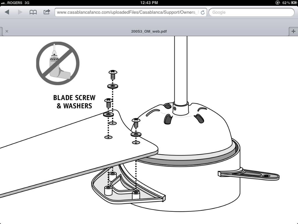

                  1st image is the new location, just wondering if the old one can be left as is and just install the new one in the other spot.
                  2nd image is current location, you can see it through the vents just above the motor.

                    you can leave it there if you want but if you run out of space, then I would remove the old controller. it wouldn't solve anything but take up valuable space under that canopy.
