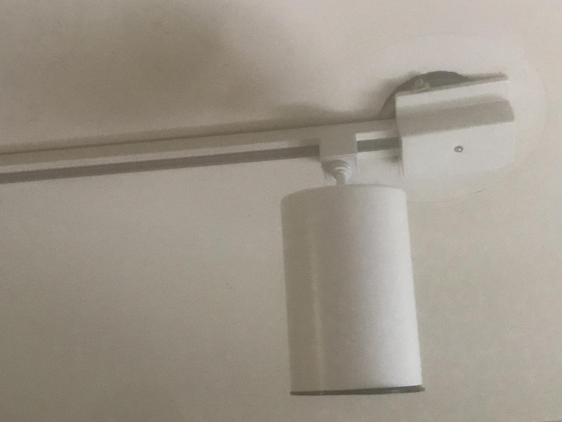

    I replaced an old wide base ceiling light with a new track lighting fixture. The new fixture is smaller and you can see unpainted ceiling and even the box behind it. I know there must be some kind of flat white metal plate that can cover the unsightly ceiling but i don’t know what you call it, so i can’t search for it on google or Amazon.
    What do you call this flat covering?
    How do i fix this?
    Here is an image (i hope):
Name:	Light fixture too small IMG_1673.jpg
    check the wiremold company for a round ceiling box. you may need to modify the round box to fit your track lighting track itself.
