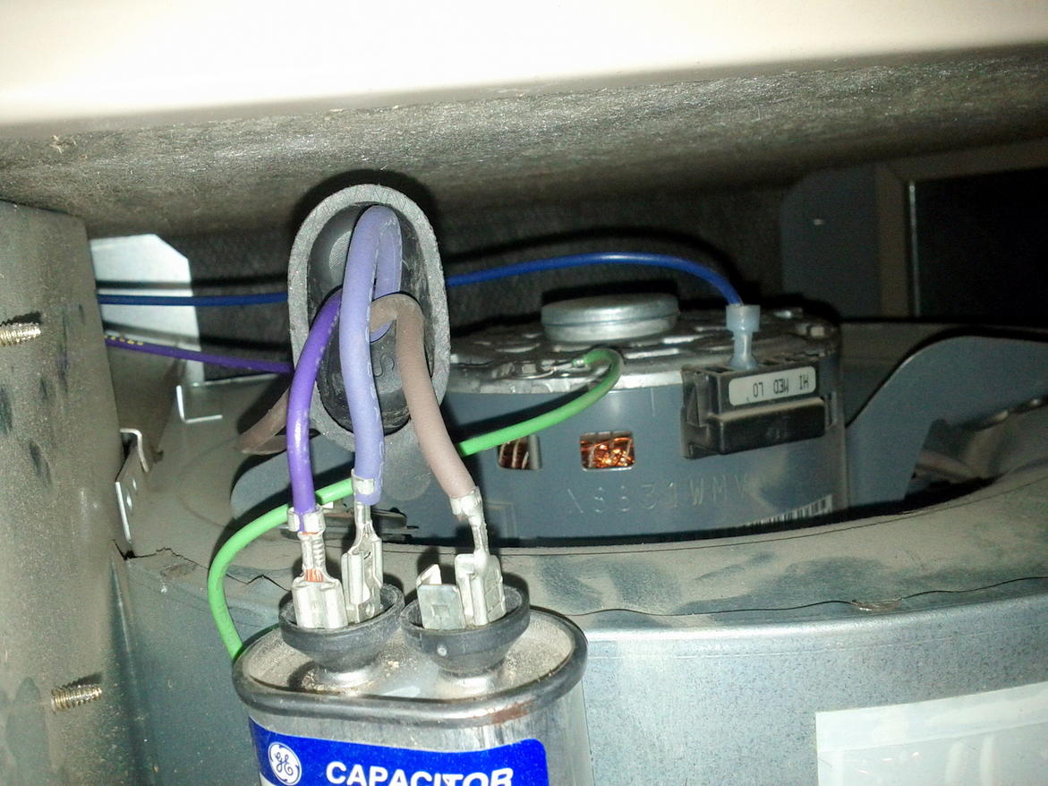

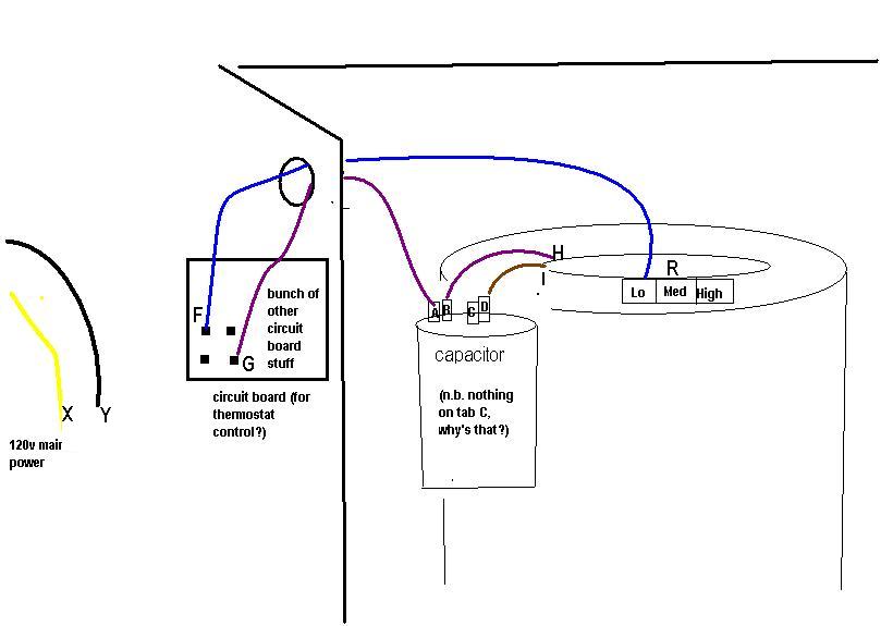

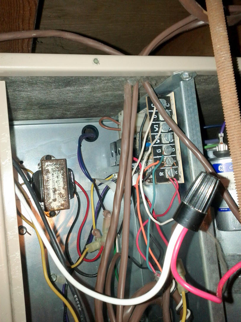

              photos and drawing
              Went back down to look at things and decided that I had better not tinker more with something I so poorly understand (Capacitors etc.) (Curiosity + ignorance usually = trouble ) So, here are some photos that might shed some light for someone actually knowledgeable. I'll now read up on Capacitors but, if you look at the wiring "picture" (I wouldn't grace it with the label "diagram") I am wondering why there is only one input (Purple to A) to the capacitor but apparently two outs (Purple from B and Brown from D.) when I hardwired my electric leads (X,Y) yesterday, I (maybe foolishly) wired them to B and D. and that resulted in the fan running when I spun it. can you figure out anything from these photos and sketch.? Can anyone tell me how I can test that Capacitor? Or how I would wire it up to the live power to test the system with the capacitor IN but the circuit board Out.? Though on the other hand, I don’t want to do something boneheaded that might cost me a $300 fan. Peter Toronto, Canada
                motor
                ok, looking at your photos, the brown goes into the motor, the larger purple goes into the motor, the small bright blue is 120 volt motor speed to the hi-lo-med connector block. the small bright purple looks to be the neutral. the two designations you give F & G are on the motor board. I'm gonna try to find this motor from what I see. the numbers I see are XSS 31 WMV - I'll check out grainger replacement motors first then go to my HVAC blower motors. thermostat connections are usually marked TH-TH on a control board. Motors have T1 & T2 for connections. Line input are L1 & L2.
                  blower
                  what make is the furnace? this will narrow it down somewhat. my sources page lists 108 pages of 15 motors per page. I went through 22 pages looking for a motor with a speed block on it. the numbers xss 31 wmv doesn't jive with what's listed.
