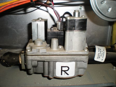

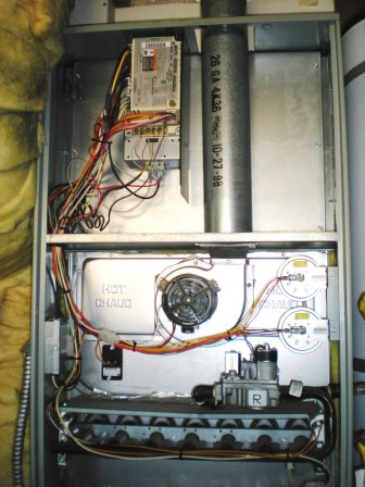

    I suggest suspect the valve is intermittent. Can you please tell me, according to my picture:
    What kind of gas valve I have? I assume this is the unit labeled “R”. How to test if this valve is faulty, online?
    What is the function of this small fan at the exhaust?

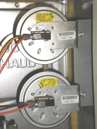

    What is this two round metal cans, labeled “P02 Low” and P01 HI”?

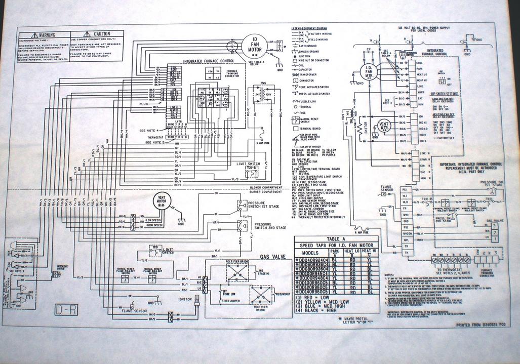

    R is your main gas valve, the two "p"s are pressure switches. the one labeled low would be open and the high would be closed. it looks like they're part of the burner's safety system. you need to look at your system schematic to see what conditions apply for your burner valve to open. we can just guess what's supposed to happen at this point.

      attached please see the schematic
        small blower in exhaust
        that blower is also called the induced draft fan. it imparts a negative pressure so that the burners will ignite. I'm looking into the main gas valve from several sources.

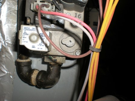

            I can see the Goodman gas valve White Roger 36E54,
            but how do you know its type 238?
            In the photo, you can see the part number 36E54, but have 201 after the part number?

                Looking at the valve picture, what is the exact manufacturer and model number?
