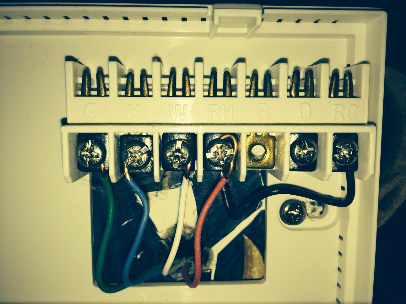

I attached a picture of the unit and all the wires. there are 4 wires, Greenm Blue, white and red with a black jumper wire, from red ( RH) to (RC). I also noticed that the blue wire is connected to the Y. I am not sure why the picture cant be open to offer a better view.Last edited by dcusack; 12-01-2013, 08:45 AM.Comment
