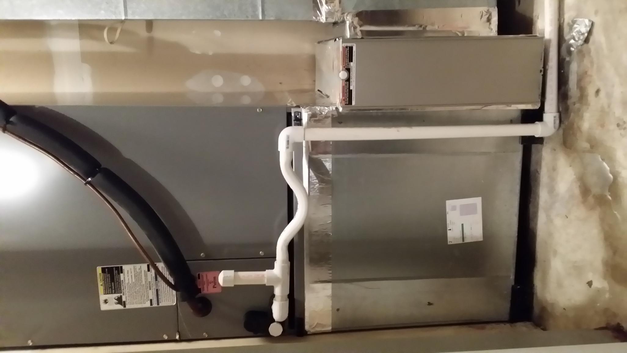

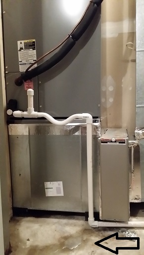

          Thanks. During the last few days I let the unit rest; I turned the AC off and just let the fan run. I also changed the filter. Someone told me this would melt any possible ice inside. I then turned the AC on, and the house is nice and cool. However, I don't the the water drain from the pipe meant for draining the water. Instead it runs from the bottom of the unit. I have enclosed a picture. Someone told me the pipe gets clogged with gunk. They told me to tap it with screw driver or something, and see if it released. I did that but I don't see the pipe working. Can I / should I open the panel, and what should I do before it? Should I just turn off electricity to the garage? Or should I just get an AC person come over, and clean the drain. I tried to twist the drain pipe, but it is glued in place it seems.Click image for larger version

            that plastic piece to the left of the drain looks like a screw in plug. remove this. you should be able to clean out what ever is in there. question does the drain line hook into your house drain plumbing or is it just positioned over a floor drain? if the exit piping just sits over a floor drain or even a french drain, why do you need the trap? the trap is used just to prevent sewer gases from entering the living spaces.
            • akaothermick
              Absolutely incompetent
              • 141
              The plastic plug to the left is the upper drain port that was never hooked up, there are two drain ports, one for a backup, upper and lower, yours was plugged. The Tee with the capped riser is your clean out port, the cap should come of and clean from there, pull the evaporator cover and clean out the condensate tray and vacuum the evaporator coil it is probably dirty too, carefully with a brush vacuum nozzle, but do it dry don't run the AC a few hours prior to cleaning or its a slimy job

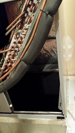

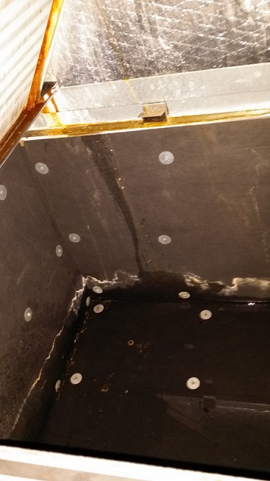

                I opened it up, and took a picture of what I saw. I think I found out what is the cause. The plastic trap under the coils is broke on one side, and water leaks to the bottom.
                I also think the unit is missing some sort of trap between the upper and lower part. What do you guys think? Here are a couple of pictures. Do you think I replace the plastic trap myself? Would home depot have it?

                    Do you think the picture I attached last is missing anything? I did not remove anything from my AC; just the front panel. I also want to ask how easy it is to install please. Do you think I can do it by myself? What is the name of the part? Would it be a water trap or something?
                    • akaothermick
                      • 141
                      That would be the condensate tray, knowing the manufacturer of your unit you could get a replacement, but removing and installing is a little complicated, try a field repair with something like JB Weld epoxy, it could work and save the trouble.
