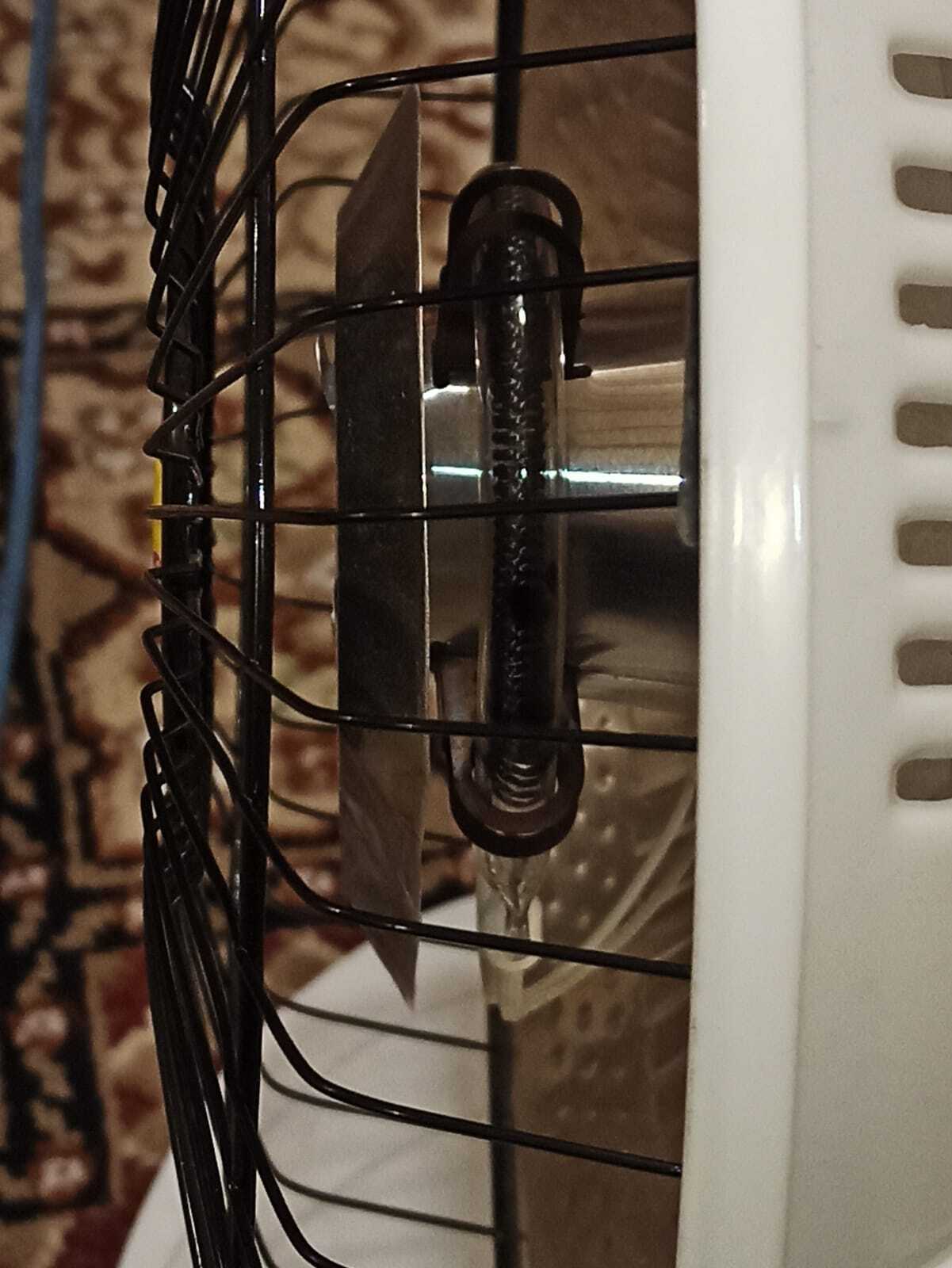

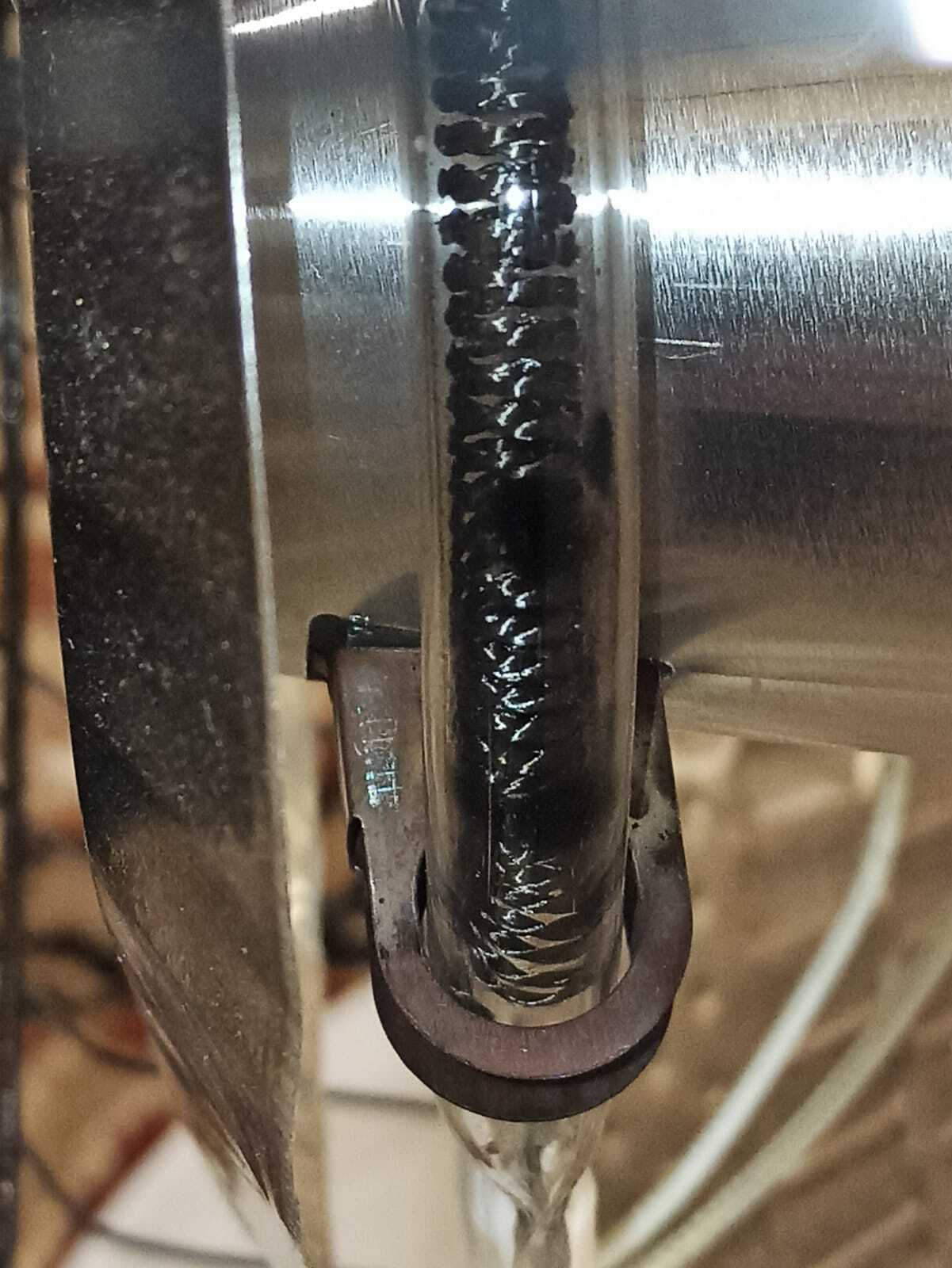

      Hi, Machinist. It did smell like something was burning, but that only happened once. The heater seems to be working fine. It has two settings, and both are functioning properly. I can't reach the spots because there is a grille. Kindly see the attached pictures.

        The black spots on your heating element's ceramic/glass coating are a serious safety issue, especially combined with the burning smell you experienced. What you're looking at is likely deterioration of the protective coating that insulates the metal heating element. When this coating breaks down, it can expose the metal element underneath, which creates a significant fire and electrical hazard.
        The fact that the heater still works doesn't necessarily mean it's safe to use. Think of it like a fraying electrical cord - it might still conduct electricity, but the damaged insulation makes it dangerous. These ceramic-coated heating elements are designed to operate safely only when their coating is fully intact. Once that coating starts to break down, as shown by those black spots, the risk of electrical arcing, overheating, or even fire increases substantially.
        Given what I can see in your photos and the burning smell you mentioned, I strongly recommend discontinuing use of this heater immediately. While it might be tempting to keep using it since it's still heating, the risk isn't worth it. I know replacing a heater can be inconvenient and costly, but it's far less expensive than dealing with fire damage or, worse, putting your safety at risk.
