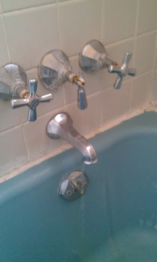

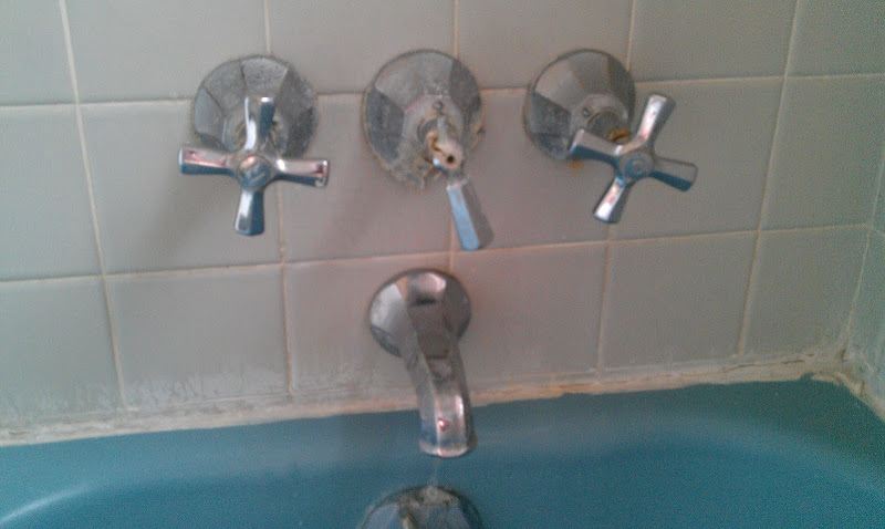

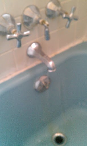

    We just moved into an old house built in 1957. Very little has been done since it was built. A bathtub facet in one of the bathrooms is constantly running from the hot water value not turning off. Also, water sprays out of the heads of the hot and cold water valves when the water is turned on for showering. It runs, but does not spray, when the water is coming out of the spout.
    Someone told me that it would require ripping out the wall to replace such old stuff. If so, I don't think we can afford it. I'm looking for a home solution because this hot water is causing major humidity issues in a bathroom without any ventilation.
    The knobs are broke and barely turn. It's a real mess for these lay eyes at least.
    I tried to see about an estimate for redoing it from a plumber, but it was going to cost $150 on average just to get someone to come and take a look.
    Input is greatly appreciated.

    I see lots of old faucets exactly like those, problem is they can be difficult to repair (if at all). You might be able to re seated and have new washers installed and this often will solve the problem at least in the medium term.
    Whats on the other side of the wall (behind the faucets) is that by chance in a closet or just drywall ? If so that might just save you a ton of money, if it's accessible (not tiled) then you can cut a hole remove and replace the whole faucet set and then either drywall it over or install an inspection cover plate and paint over it.

        Faucet cartridges...
        Hey Pushkins, is it possible for them to pull those cartridges out and get new at the local big box? Sounds like the stem packing and the faucet washer have finally failed. But I do believe parts are available...just match up what's needed. One other thing....is there a name stamped anywhere on those handles? If you can find the manufacturer, quite possibly a call to their service department could get you the help you need...

          Well it's all rusted and limed over. I tried to use CLR to get them cleaned some, but that did no good. I tried unscrewing the metal piece that goes up against the wall. The screw just top fell off. It's rotten metal by now I guess... I thought that part was at least amusing.
          Also, one of the knobs has fractured and won't even open the valve for the shower. You have to really work at it to get the shower on or off.
          This is a nightmare!
            If the wall behind the faucets is drywall or even older cement board paneling then it would be a fairly simple matter to replace the entire faucet system, being behind a fridge makes it even better you can simply install a large inspection panel and paint it all the wall color as your not going to see it anyway.
            I'm not sure where the "cement wall" your referring to is situated.
            You can buy seats, washers and packing for those faucets, it's usually it's not worth the effort unless you have a tiled wall right behind the shower wall making replacing them much more expensive.

              Derek:
              While I agree that it'd always be best to replace an old faucet with a new one, and a good way of doing that is by opening up the wall BEHIND the faucet, you should also be aware that Kissler & Company of New Jersey specializes in old and obsolete plumbing hardware.
              Kissler | Plumbing Repair Parts
              ph. 1-800-547-7537
              Kissler buys parts for faucets from the companies that made those parts for the original manufacturers, and they even have their own in-house machine shop where they make their own brass parts if they're not available anywhere else.
              Talk to Doug Tanner over at Kissler and e-mail or fax him one of those pictures of your faucet so that he can better identify it. If there's any manufacturer's name on the faucet handles or wherever, that would help as well. You can also download Kissler's faucet parts catalogue from their web site and see if you can identify the parts you need in there.
              Also, Kissler has a minimum order of $250, so you won't be buying from them directly. Instead, phone their 1-800 line and ask to speak to someone in accounts receivable who can tell you which companies order from Kissler on a regular basis. You can then order from that company. I know that Sexaur in the USA orders from Kissler, as does the Handyman's Inc. chain of hardware stores in the northern central states.
              I own a small apartment block, and I have about 20 Crane Tub & Shower faucets in my apartments. However, apartment blocks are built with fire separations around every stack of suites to prevent fires from spreading laterally. So, in my building, the tub & shower faucets have a ceramic tiled wall in front, and a concrete block wall behind them, so the option of cutting open the wall behind the faucet isn't open to me, thereby making the situarion very much more serious if I can't get parts for those 20 Crane T&S faucets. About 5 years after Crane discontinued making their Tub & Shower faucet, parts for them were no longer available from Crane. A good 10 years after that, I was still able to buy 30 escutcheons for that faucet at $6 each from Handyman's Inc. in St. Cloud, Minnesota who ordered them from Kissler in New Jersey who got them from the original manufacturer in Taiwan. And, I can order another 30 tomorrow if I want.
              Most likely the "cement wall" you're referring to is either a mortar bed for the ceramic tiling, or a product called "Gyproc lath", which was a fairly short lived product used between wood lath plaster and drywall. Gyproc lath comes in 16 inch wide by 4 foot long panels and is a gypsum core sandwiched between two layers of paper just like modern drywall. It was only used in the late 50's and early 1960's. Prior to that, wood lath plaster is the norm, and after that, drywall is the norm.
              PS: The 4 1/4 inch square ceramic tiles on your wall are part of a line called "Colour Collections" made by "Maple Leaf Tile" which was is a subsidiary of Olympia Tile here in Canada. Olympia Tile is still operating and any ceramic tiling retailer in your area should still be able to order Colour Collections tiles from Olympia Tile here in Canada. Maple Leaf was a very popular tile in the 50's and 60's because it came in the same colours as both American Standard and Crane used for their bathroom fixtures. Also, Maple Leaf doesn't change it's product line nearly as frequently as other ceramic tile manufacturers so even though your house was built in 1957, it's very possible that the same tile is still available from Maple Leaf, or at least, something exactly the same size and of a somewhat similar colour.
