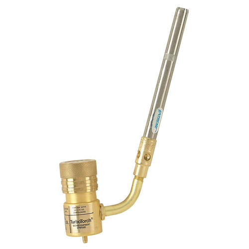

                  1. Don't buy any torch. Buy a torch that mixes the fuel with the air before igniting it. For example, this torch is made by a company called Turbotorch in Texas. It's called the STK-9 and it's very popular with plumbers because it draws air into the four holes in the brass base of the stainless steel mixing tube, thereby mixing air and fuel over the length of the stainless tube. The result is a very much hotter flame than you'd get if you didn't mix the fuel and air together first.
                  That mixing of air and fuel before burning is how a bunsen burner works. You want a HOT flame so that you can bring the fitting up to soldering temperatures rapidly so that nearby solder joints don't start to melt on you.
