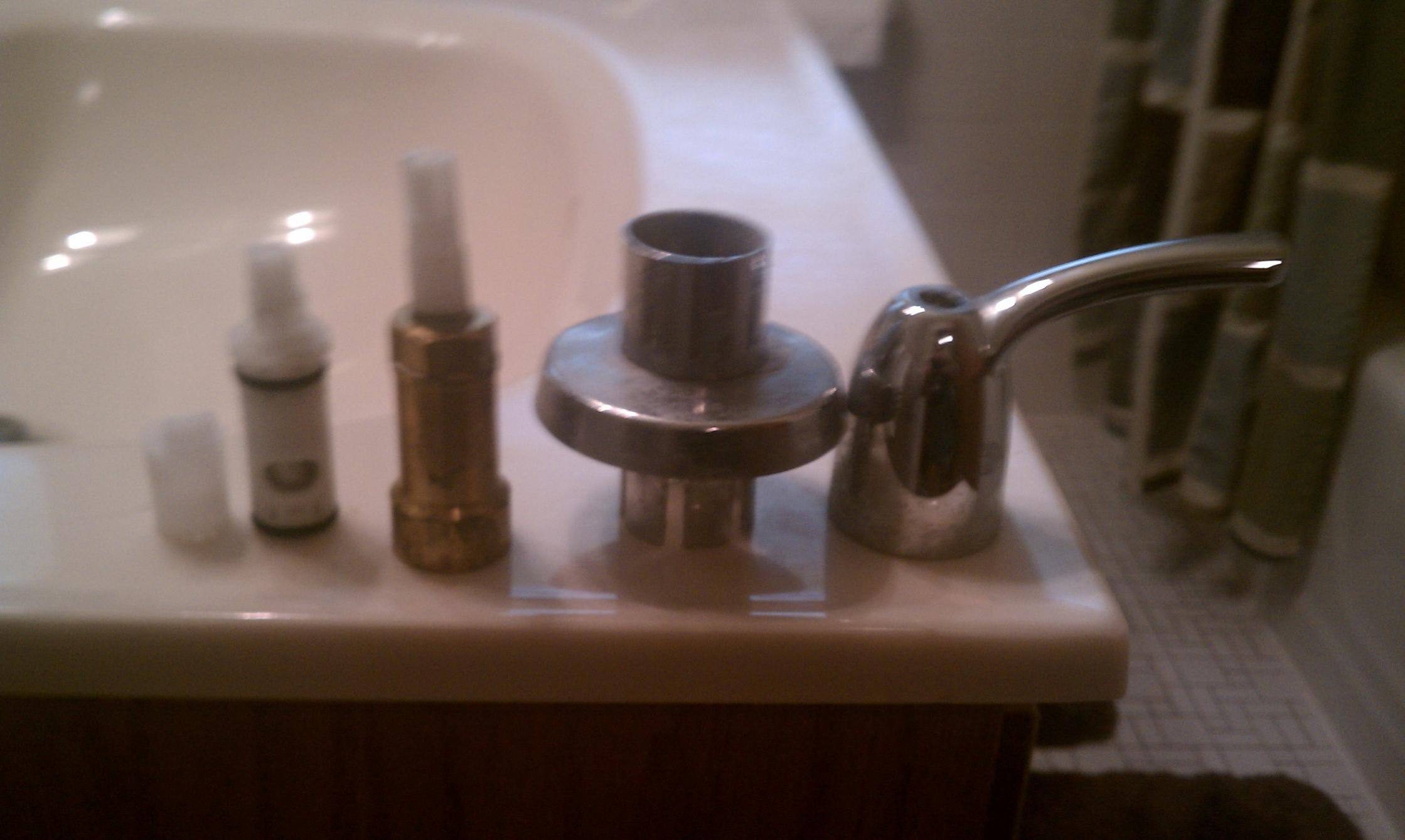

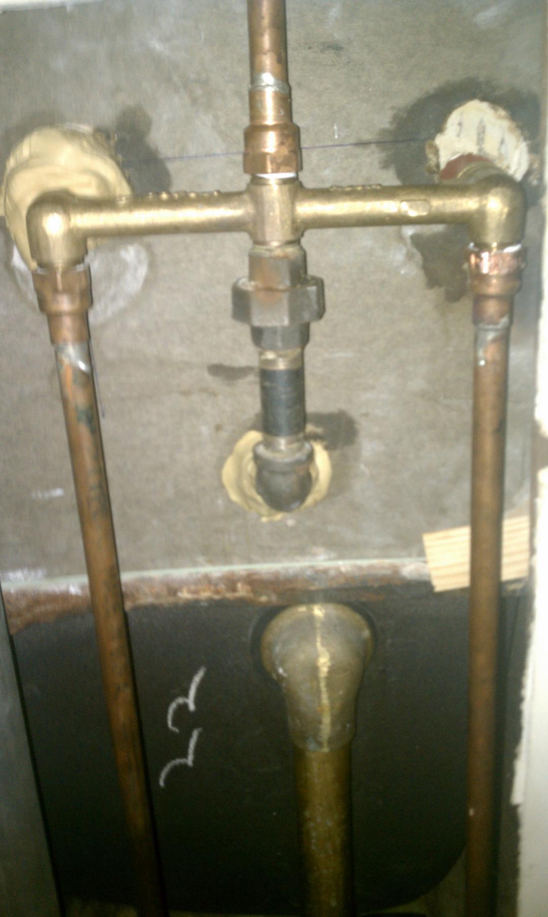

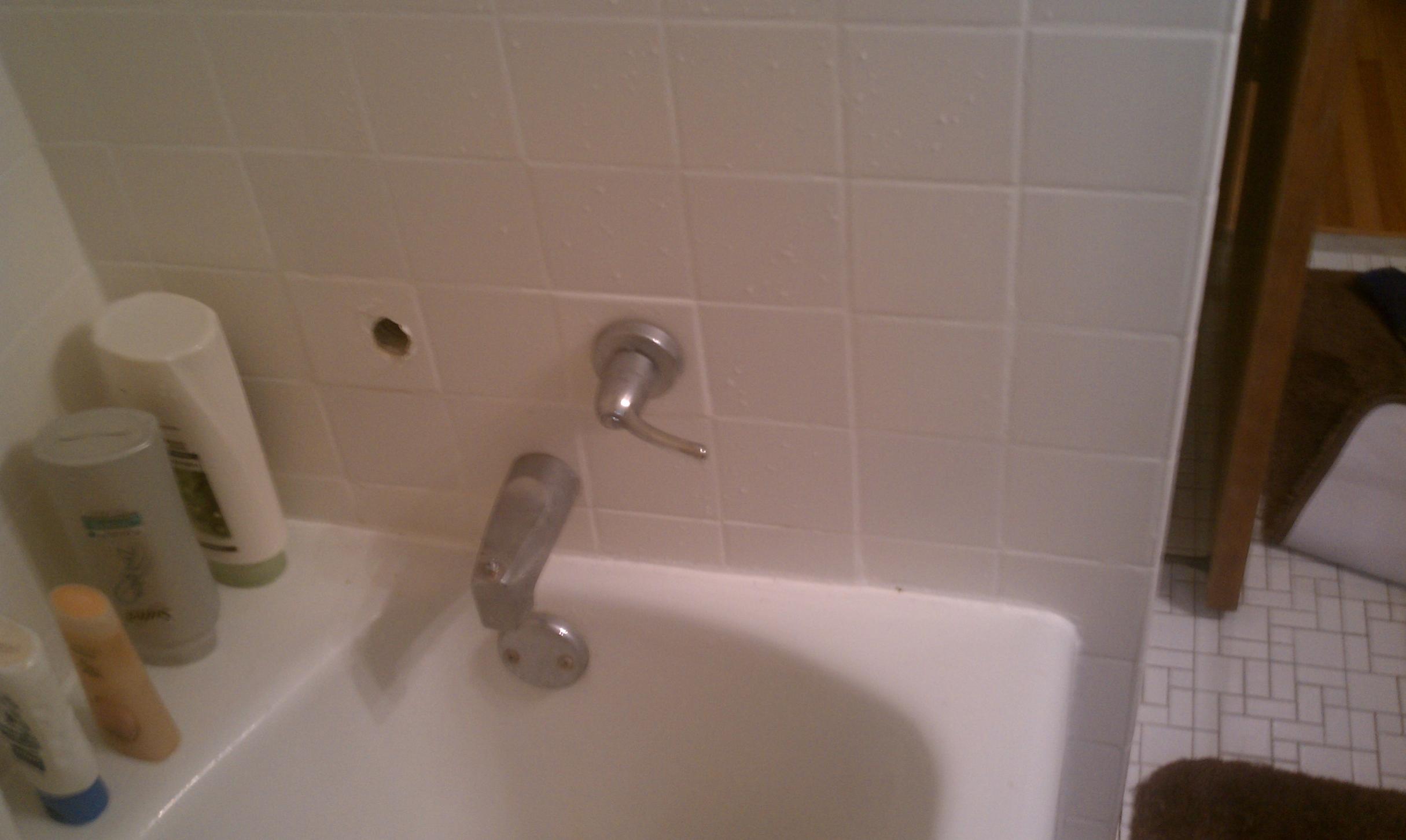

    Father-in-law said the rusty water would go away over time, but it hasn't. It hasn't gotten worse and it hasn't gotten better. I'm grateful for his help, but I'm thinking that something wasn't done right. The faucets and hardware were a pretty cheap Moen variety, but I've inspected them and can't see any corrosion in them. Right now I'm wondering if it isn't being caused by the dissimilar metals that are involved. I've taken some pictures of everything in the hopes that you guys might be able to say, "THERE IS YOUR PROBLEM!" Am I on the right track that the different metals are likely the culprit?

    problem is the nipple and malleable elbow. these are both steel and rust inside. why would you sweat solder a new fixture with copper and not the spout pipe? replace this and your problem will go away. use a drop eared elbow on the outlet side.

      Thank you very much. I replaced what you told me to and there was no rust this morning!
