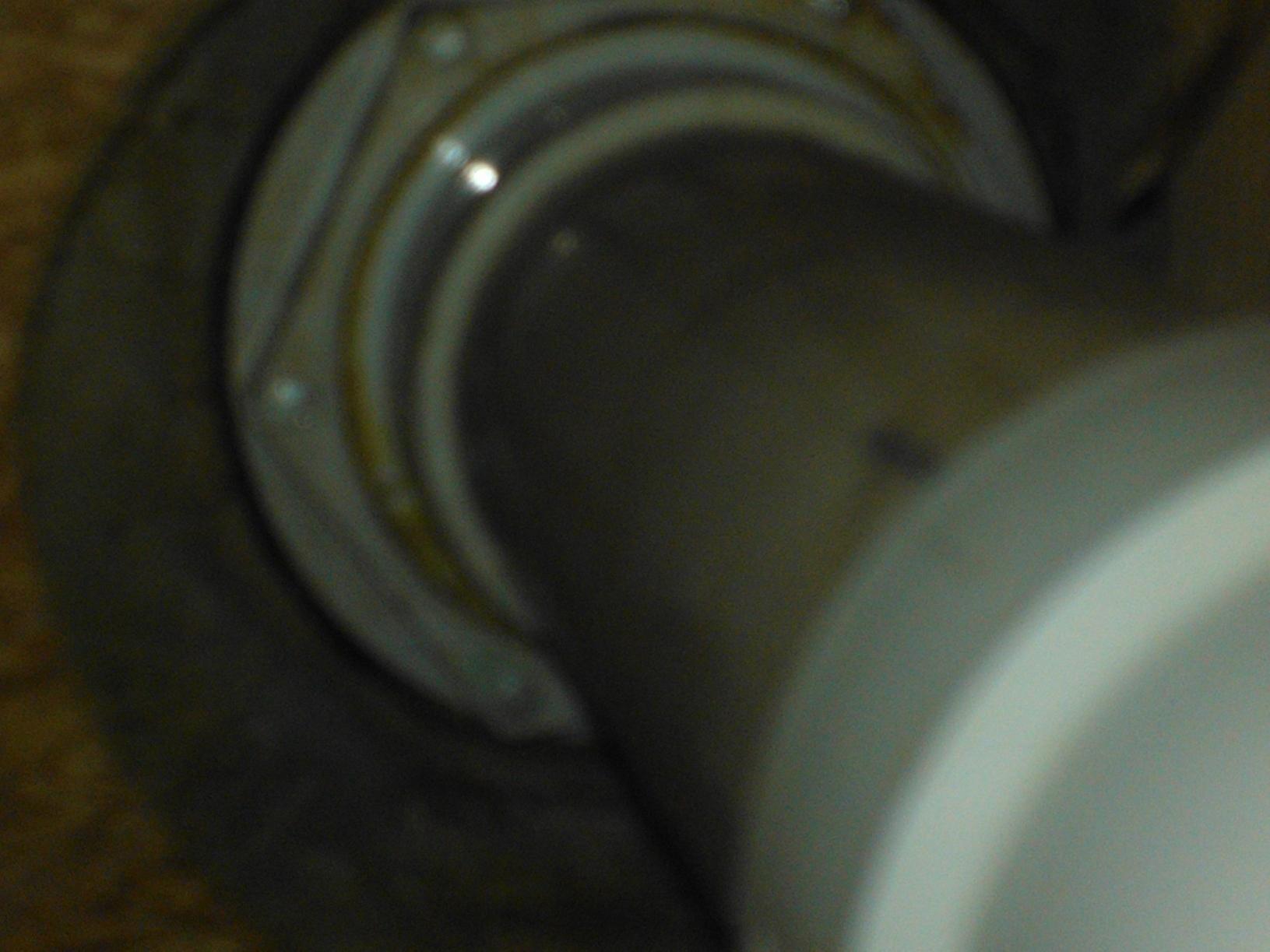

        M aybe these will help a little

            I think I can see the rubber washer right above the big nut against the under side of the shower (black ring in the picture)

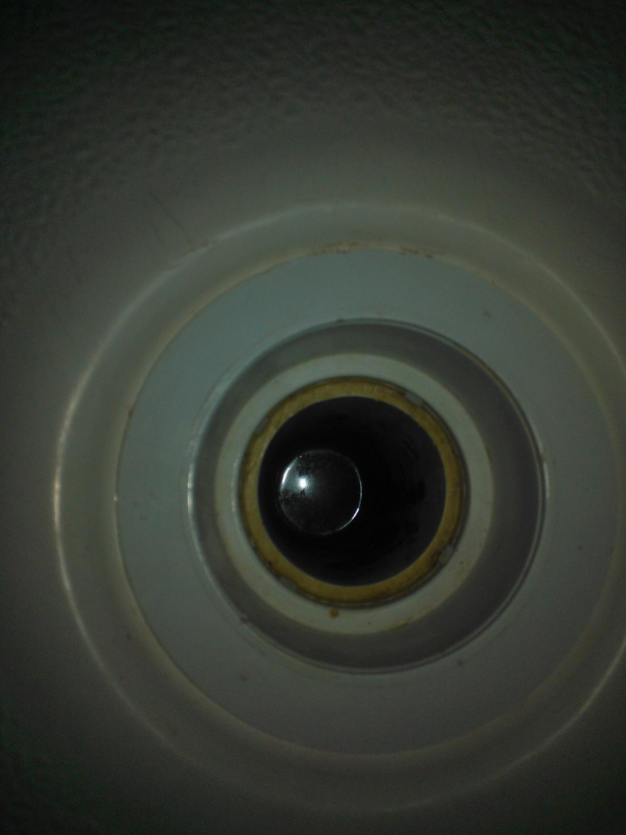

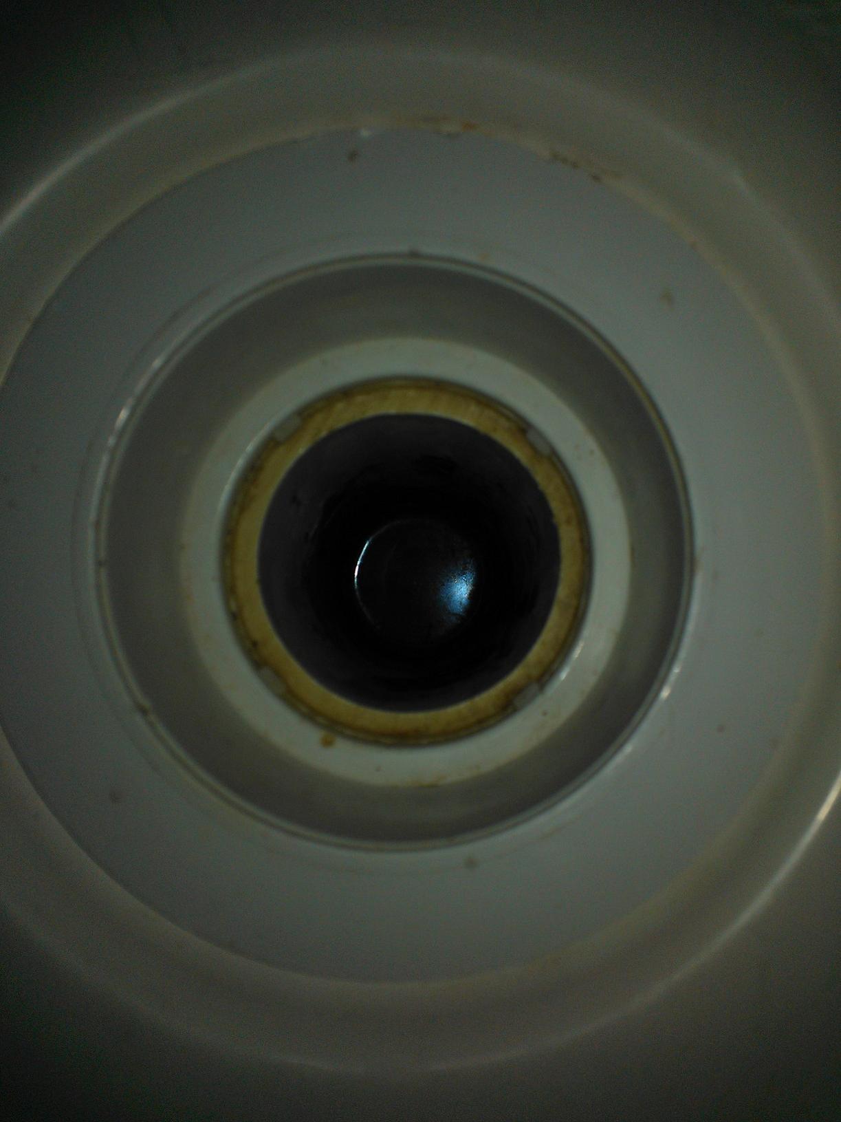

            You should be able to undo that big nut and slide it down the pipe, Undo the drain pipe gasket (that"s the threaded part seen from inside the shower stall looking down into the drain), from there you should be able to remove the shower stall side of the drain, clean the area well and reapply a bead of plumbers putty all around the hole in the shower pan, drop the fitting back in. From the underside you will slide the rubber washer and the cardboard ring back up the pipe and tighten the big nut.
            A close up picture looking at the drain from inside the shower stall would be great.

Name:	inside shower.jpg
ID:	87095 Push, here is that photo from inside the shower. If you click on the photo, it should blow up for ya so you can get a better look. One, question...how do i get this part unscrewed? I was told there was a tool i could buy that would fit down in there on those notches but it didn't work....I am pretty lost at this point. Also, the nut on the underside....what do you suggest to get that loose? Again, thanks for the help.
                The nut on the underside you can use a large pair of channel locks or you can even use an oil filter remover or you can buy a similar tool at most hardware stores (has a handle and a big rubber strap that wraps around the nut), if you buy one go to the plumbing department before you leave and make sure it fits the nut size.
                It looks like there should be a special tool for that internal nut (?) it would have 4 little slots in it to accommodate the 4 little prongs on the drain. Nowadays the gasket lock ring has 4 slots in it and the tool looks like a flat piece of metal with a central slot (for a big blade screw driver).
                Is the P trap under the shower a "glued one" or does it have some big nuts on it as well ?
                I ask this because if you cannot get that internal lock washer off, then you could undo the big nut then undo the shower side p trap and the whole thing will pull up into the shower stall, then you could replace the shower drain and reinstall.
                If the p trap is glued then it's a little more complicated as you'd need to cut the shower leg of the drain, remove the drain, buy a new one and install it then make the drain pipe attachment with a Fernco (rubber boot).
