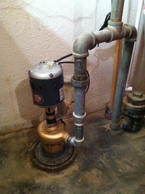

    Shellback Torpedo sump pump question
