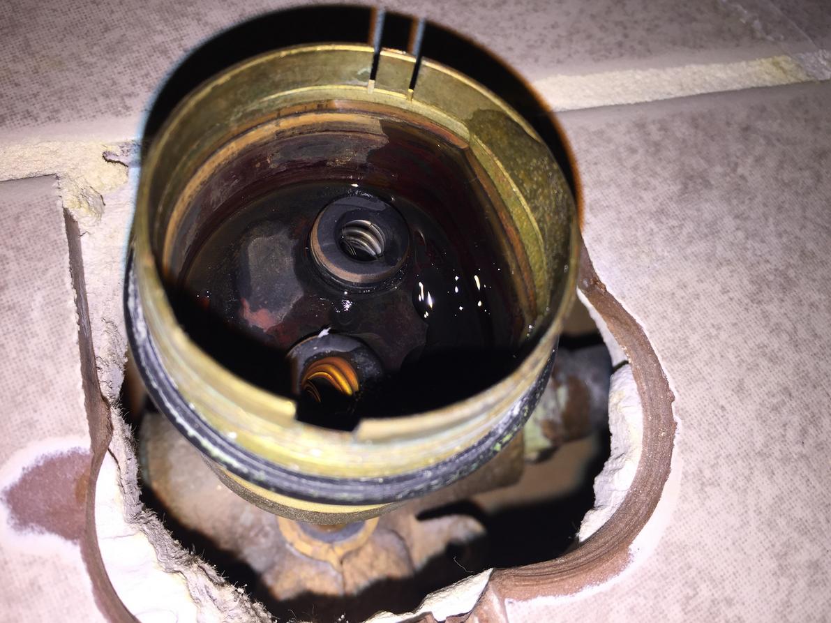

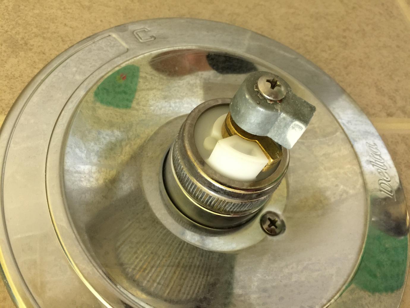

    My tub is leaking, did research. Turned off water supply, disassembled parts at handle. It's not the new grey or older white cartridge although handle and spouts are newer..Click image for larger version

    Wondering what I need to fix it?

      Delta single control faucets are pretty standard, they usually sell all the parts in a kit, available in most plumbing supply houses or big box stores, you should find them easily as its a common fixture. The kit has cup seals, with pressure springs, and a new ball if it needs one, though if the ball is a good solid one with no damage it can be reused, this is prefferable to some cheaper ball replacements, the large o-ring is in the kit also. You will find Deltas amongst the easiest to repair.
      Good luck,
      Mick
