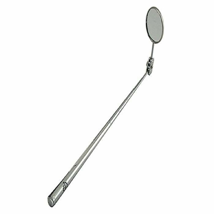

                      You may try a mechanics inspection mirror to get a look into the hard to access areas. I do agree that for a DIYer to spend money on pro grade equipment is not practical. But then again so is tearing out walls and ceilings to see into hard to access areas.
