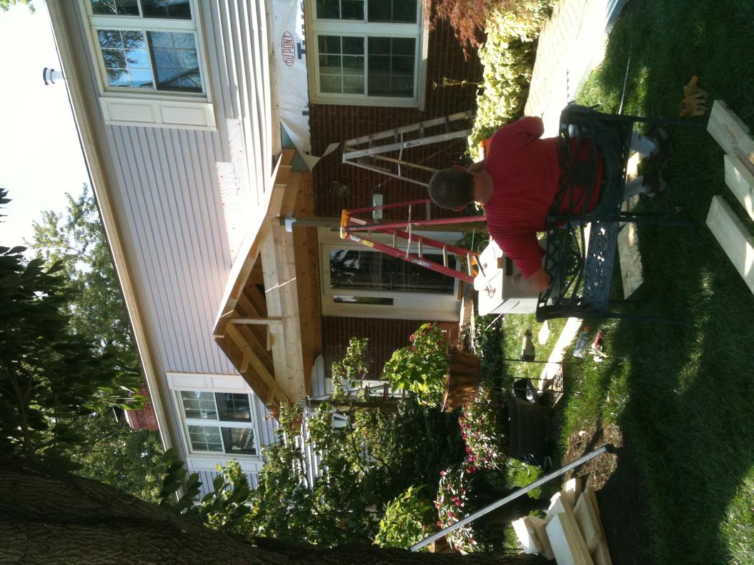

      Don't know why it turned the picture sideways it's the right way up in my folder, Anyway this was the Mother In Laws revised (bigger) edition of what she wanted. You could go much smaller if you wanted. FYI this one cost a total of $800 in materials including paint, lumber, shingles the whole package.
